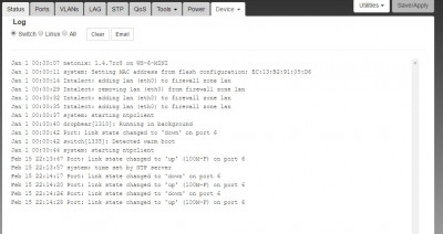

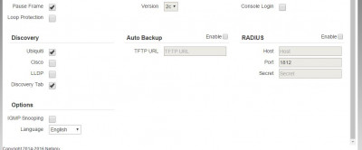

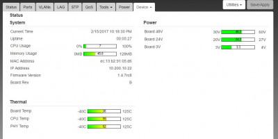

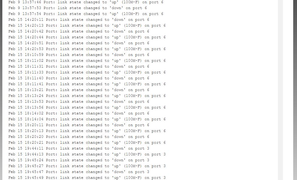

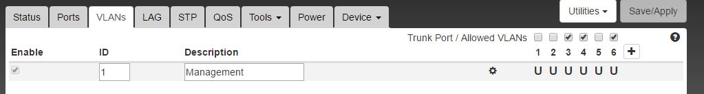

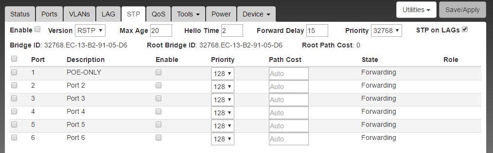

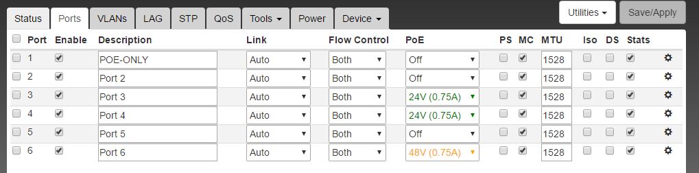

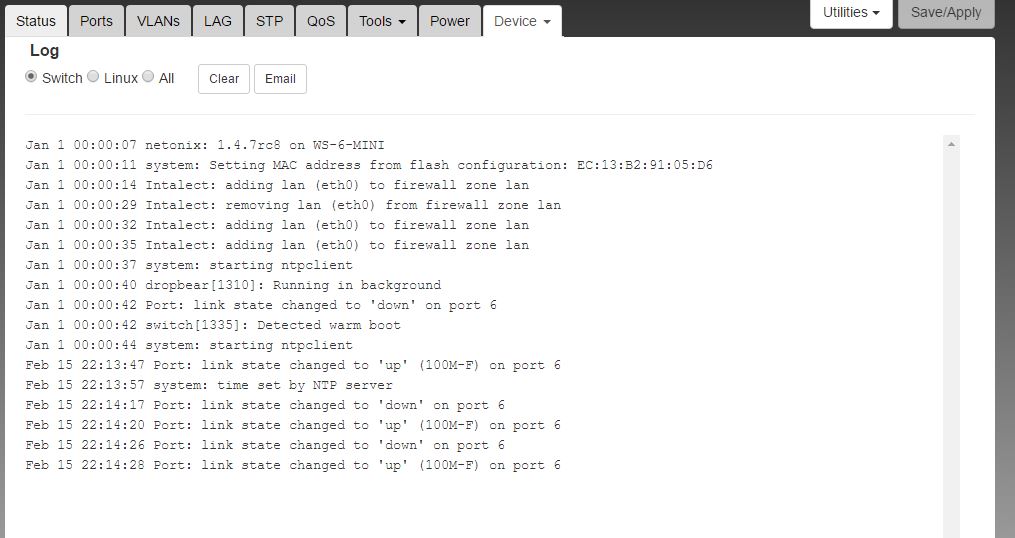

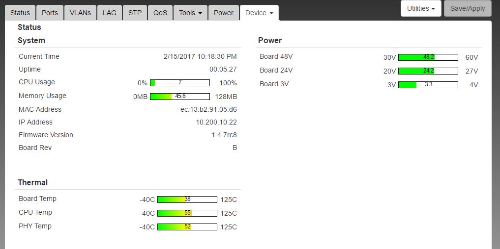

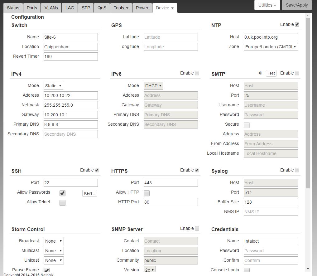

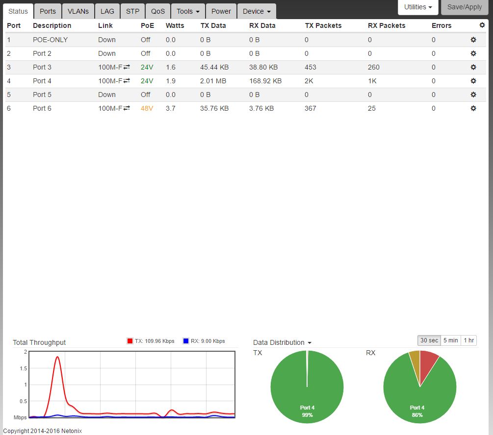

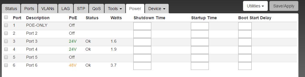

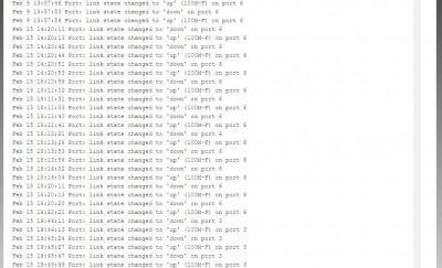

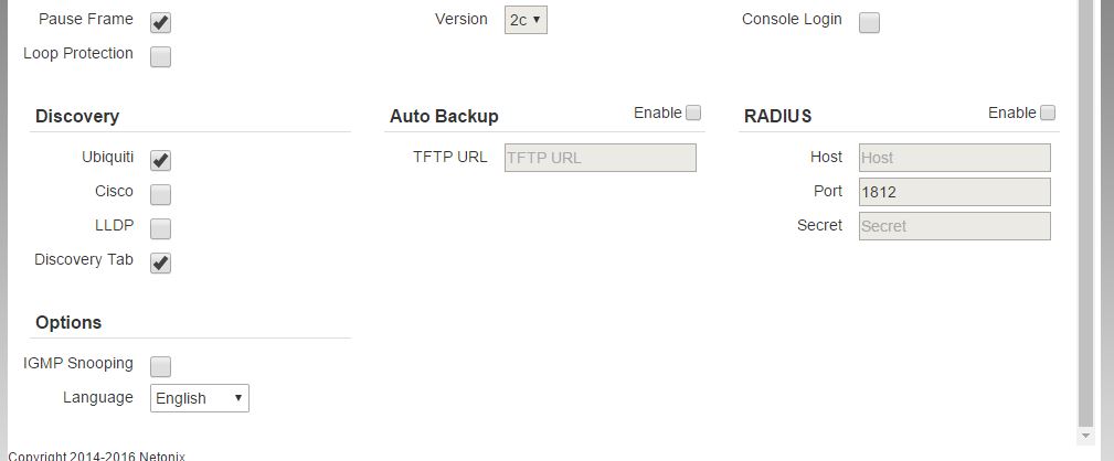

Okey Dokey... Firmware Updated to latest as requested and below are Screen Shots. STP isn't enabled but i have the screenshot just in case. The only Vlans used are 1, 101.
Also, for good measure I have added the latest view of the log which shows the port state still changing.
Hope that helps. Thanks..

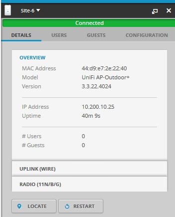

Thanks for your help so far. The AP isn't rebooting but we are having connectivity / slowness issues from clients hence why this is being looked into.
Just to cover all my bases i have also recently upgraded the UBNT controller to the lasted version and firmware'ed all the AP's too.
Screenshot attached of the controller for the AP Associated to this switch from the first screenshots and also a screenshot on another switch ( firmware 1.4.2 ) on the same Lan.. same thing happening to them all. Its all very odd
