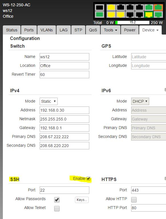

Is ssh enabled on the switch under Device -> Configuration ?

Yes, SSH is enabled.
