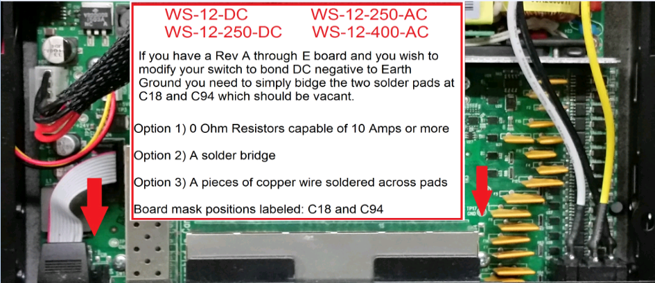

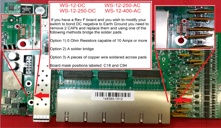

Also while you have the unit open you could consider these MODs if you are good with solder iron.
These MODs will help protect the switch from ground current flow.
We have since starting doing this on all switches as of September last year.
CLICK IMAGES BELOW FOR FULL SIZE VIEWING
