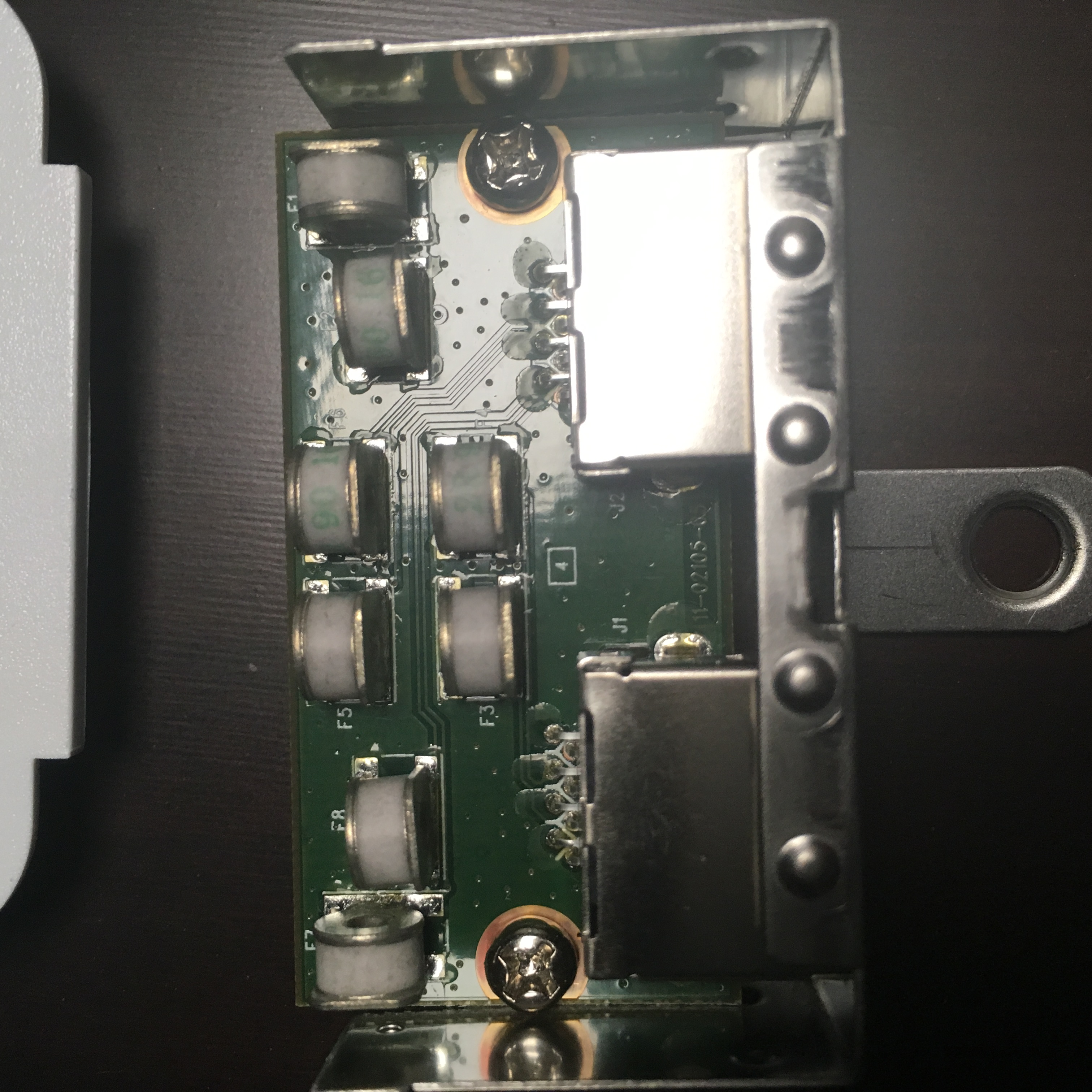

That is a very good question on what the UBNT surge arresters do or how they work as I do not use any in my WISP anywhere as I rely on good grounding which has protected me well.
viewtopic.php?f=30&t=1816
viewtopic.php?f=30&t=188
viewtopic.php?f=30&t=1429
I should order some in and tear them apart to see how they work and what they do.

The ETH-SP is designed to work with the all pairs 50V pinning of the AF24 so unless it took a hit and is now shorting to ground, it should be compatible with 48VH. Of course their raison d'être is to take a hit and short it to ground so if that happened, then after that, all bets are off.
Re: Netonix POE Smart Cable Check Error after unrelated chan
Hey Les,
I do know that most 802.3af/at Surge Arresters clamp all pairs to ground, I do not know what UBNT is doing in their arrestor, what are they doing with a presumed surge or excess voltage? How do they discharge the excess voltage?
If you have one Les you could perform some exploratory surgery on it and let me know what you find?
The principle they work on is to clamp only an overvoltage to ground and when shopping for a brand/model, one needs to be aware of what their voltage threshold is. I don't have any of the ETH-SP but as I said, they were designed with the 50V PoE that AF uses in mind so would not expect a properly working one to cause overcurrent issues. As for the diags, that is another story as they can cause false positives with the TDR function.
As I also mentioned, if they took a hit, they could be permanently shorted to ground or clamp at a lower voltage threshold so can no longer be trusted.
Surge protectors are a poor substitute for good grounding/bonding practices. They are mostly meant to meet NEC entrance protection requirements to protect life and buildings.

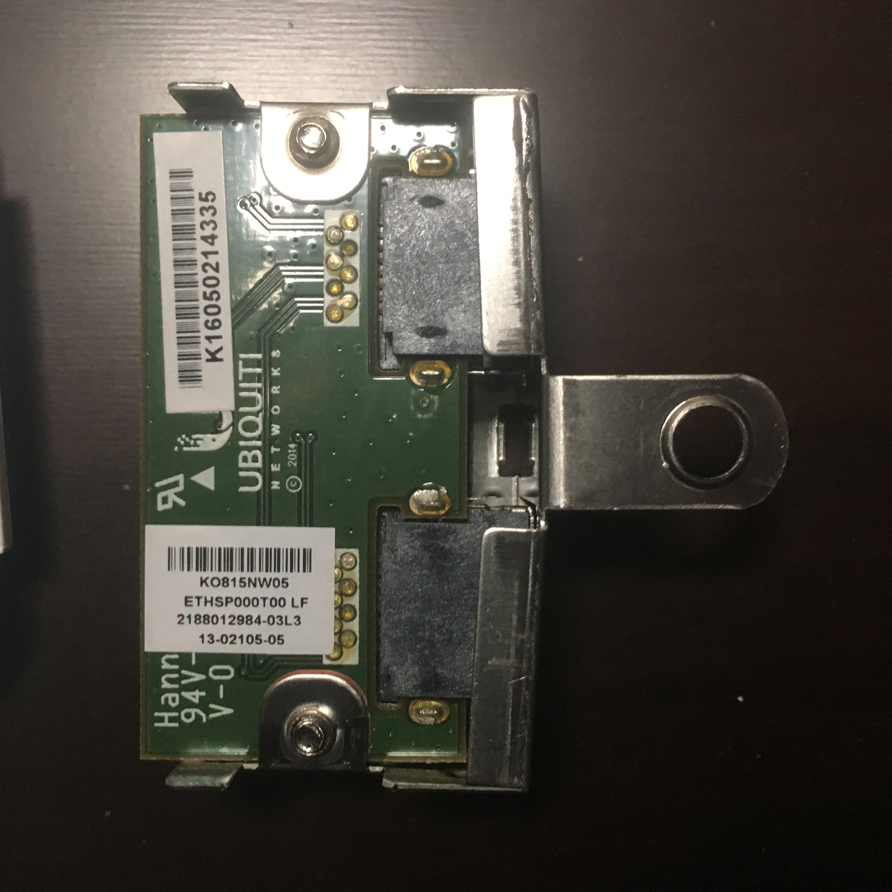

sirhc wrote:If you have one Les you could perform some exploratory surgery on it and let me know what you find?
Need anything else ?
