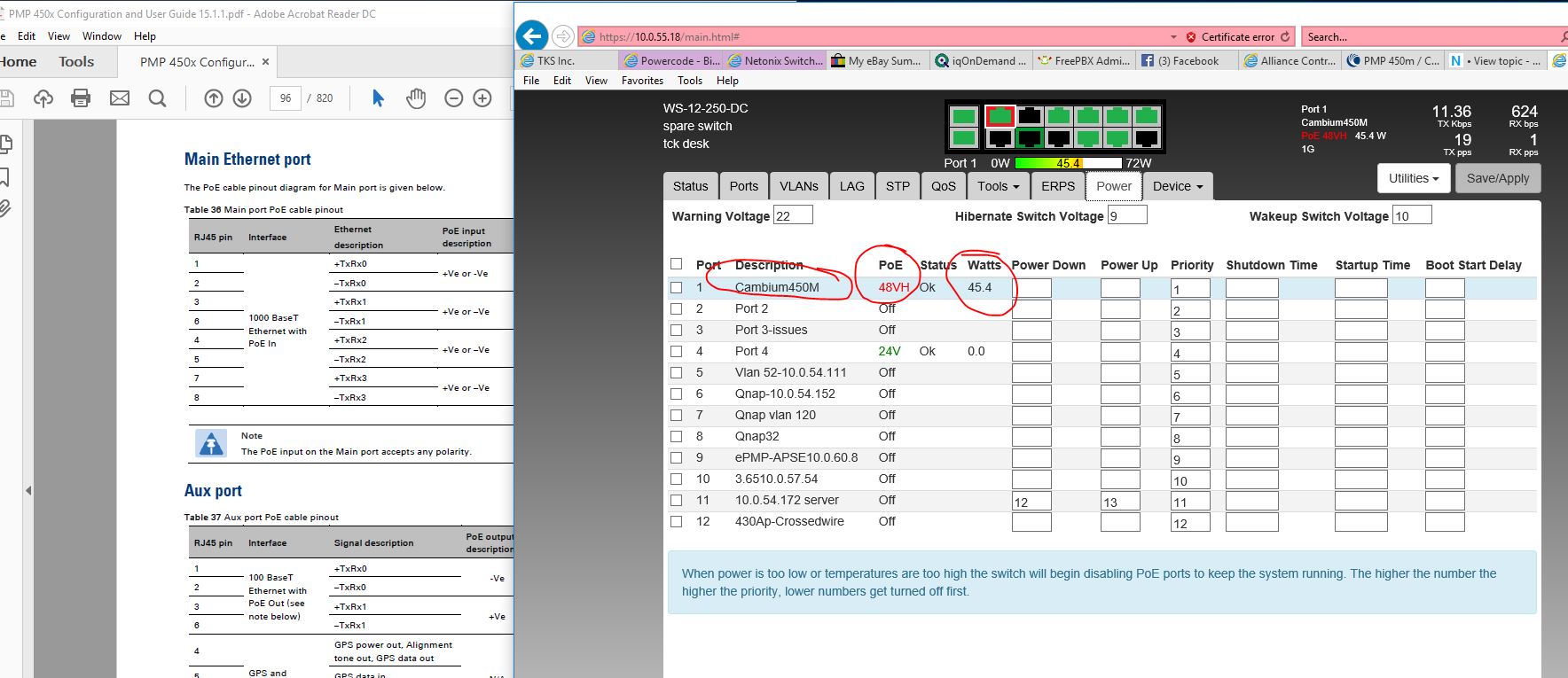

Re: PMP450 Medusa
I am running one on Netonix WS-12-250 on 48VH,
straight cable,
Update, not sure if this power supply is too low at 52 volts, radios are not performing well, and cambium is blaming the low voltage,
have not seen ap pull over about 70 watts, but have not turned power all the way up on the radios,
My bigger issues was overran the full capacity of the switch, not necessarily one port maxxing out,
straight cable,
