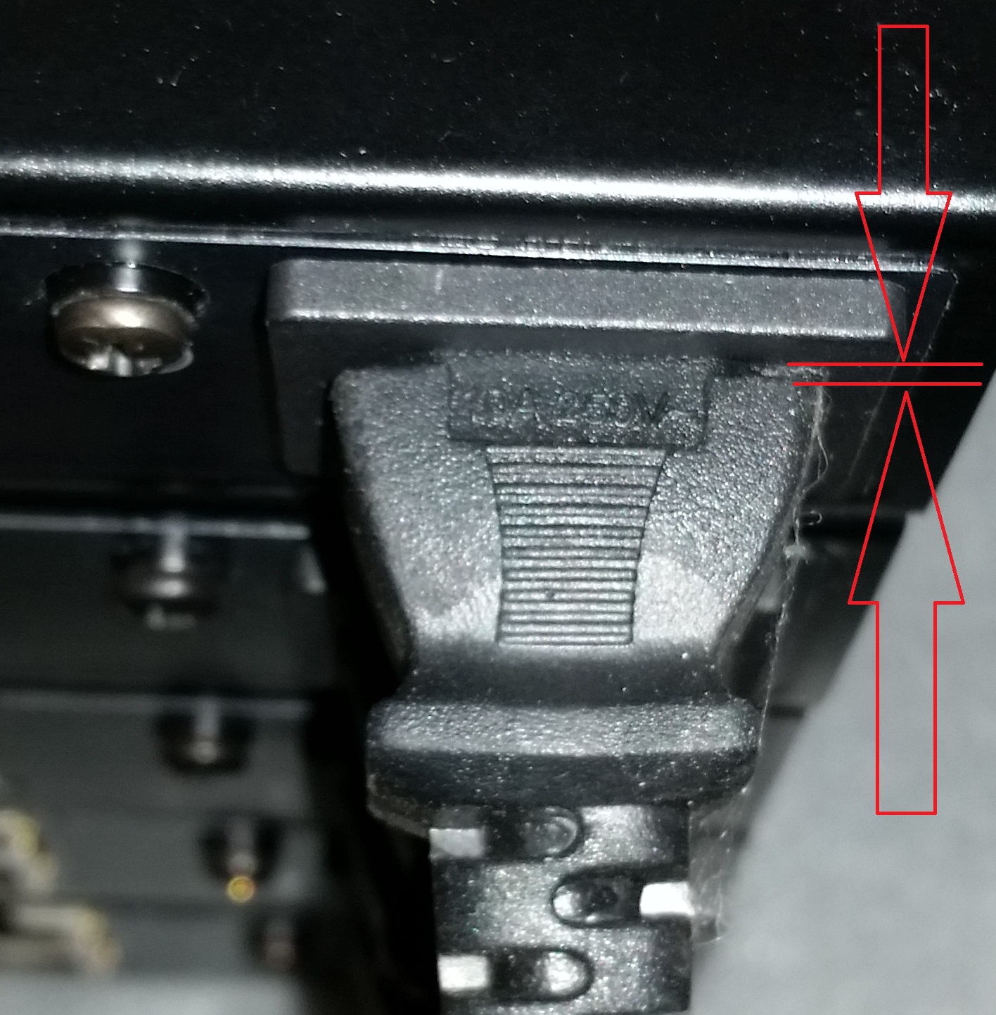

When I say Push in hard the first time I mean HARD. I sent a hole shipment back once to factory and they schooled me on what I was doing wrong.
Should look like below when fully inserted:
