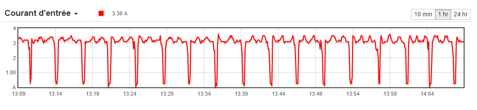

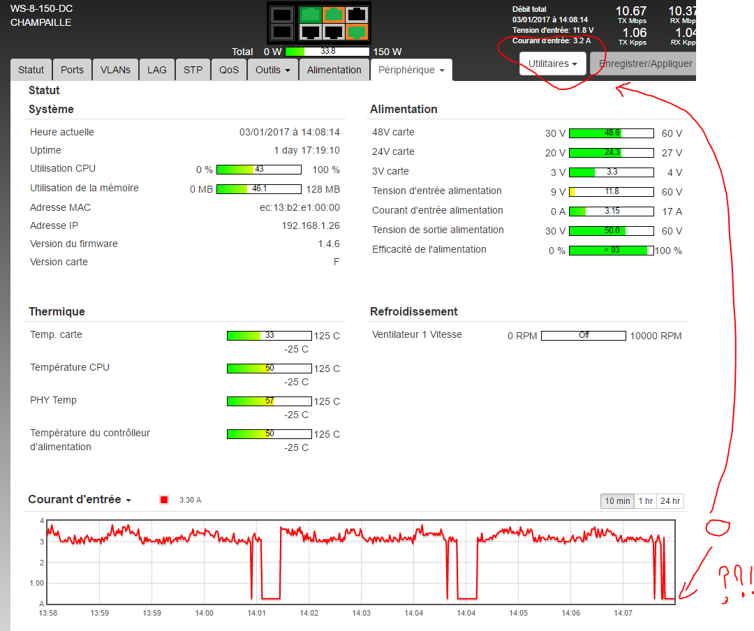

I have voltage drop peaks at the interface display on one of the WS-8-150 ... :shock:
What is bizarre is that it is regular ... .. Attached photo
My system detects no cuts
Do you know why ?? :screwb:

There are a lot of reasons that loading can vary: Radio going into low power mode after not finding a link, network traffic slows or spikes, a powered device is rebooting, etc.
The question I'd be investigating is whether my network was working as intended, it seems as though yours *might* not be, but I can't answer that question for you.
