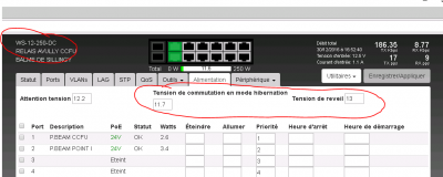

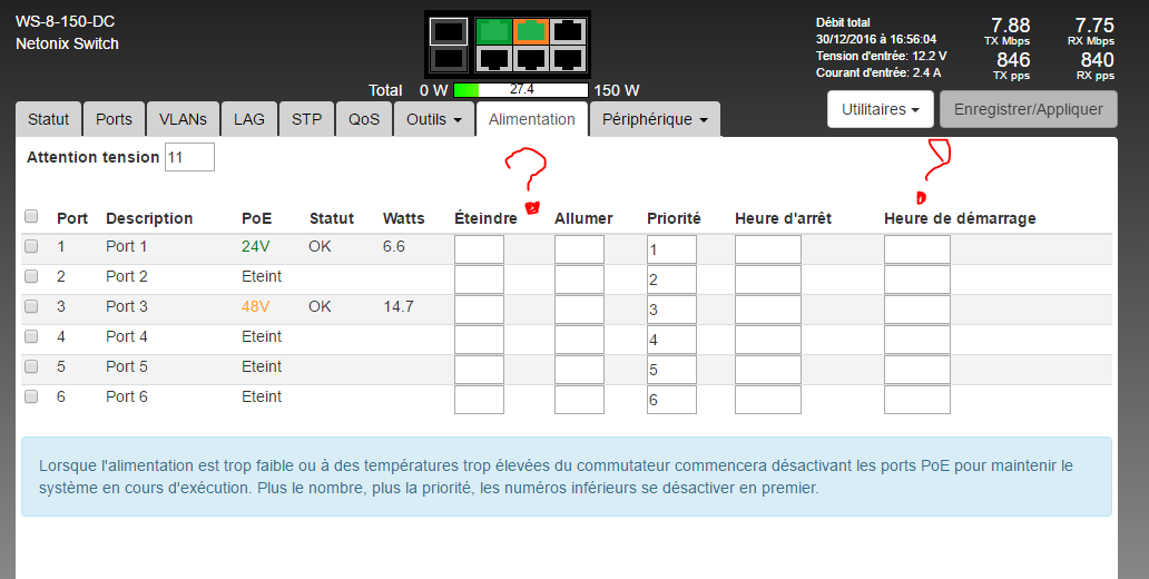

Hello
It lacks on the switches the voltage at rest and restart ???
Why ? :yikes:
I have the latest update on the 2 switch

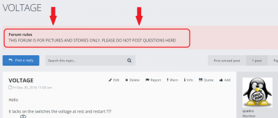

OK, well first I moved your port out of the forum where you post pictures of installations. :ak:

The WS-8 does not have the same hibernate option that the WS-12 has. This was done to reduce cost. If you need that option, then buy the WS-12.
viewtopic.php?f=6&t=2368

I find it unfortunate that this option does not exist on the WS-8-150 because the main power on this WS-8-150 is the battery !!!
And if the battery is in deep discharge because of a solar panel that no longer works the battery is out of service !!!!!
We bought this product for the purpose of the adapted in our box because it is smaller
For the price we are willing to pay more expensive to see the same price as the WS 12! :agree:
BUT Please add this OPTION !!!!!

We cannot add that option to the WS-8 without a complete re-design and testing.
This would drive the cost up quite a bit, people wanted a less expensive smaller option.
But as Les said the more expensive WS-12-250-DC does offer the LOW power consumption hibernate option.
