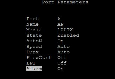

Hopefully something granular. Below is an example of how another product does it (maybe some ideas).
On a port basis alarms can be turned on / off (although maybe not the best idea as there are things it would be nice to be notified about)...
Port setup parameters - including disabling alarms.
port parameters 20161215.jpg (17.39 KiB) Viewed 20550 times

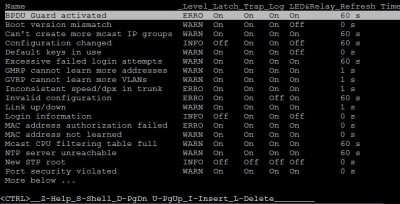

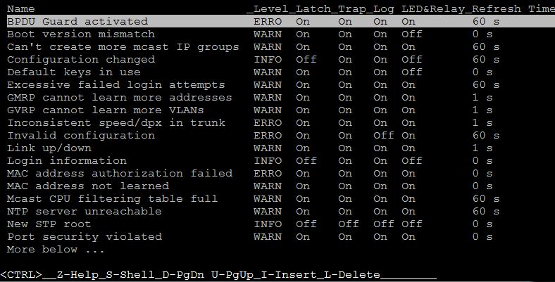

...alarms overall can be adjusted (you can't change the level but you can adjust what is done with them and how often they refresh)...
Allowed adjustments for what is done with alarms.
