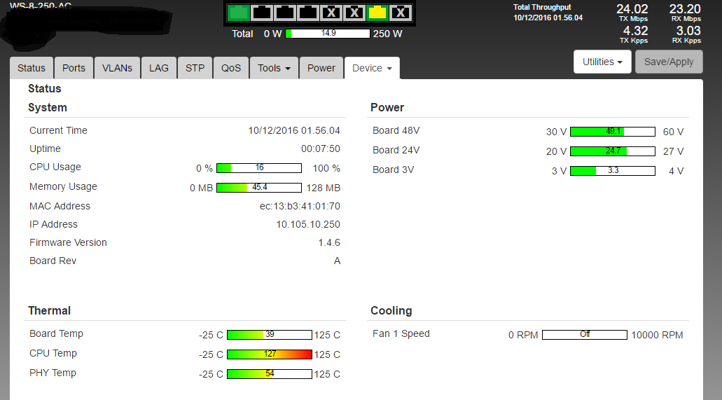

Hello discovered this evening a switch, where the fan is off and high tempertur.
Is there a way to turn it on again ?? :D
Or is it broken? :ak:

That is either a bad sensor or the switch need power cycled.
The CPU sensor and PHY sensor are built into the chip.
The board sensor controls the fans.
