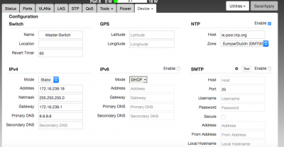

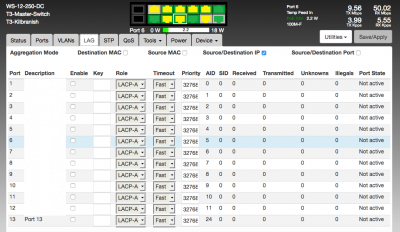

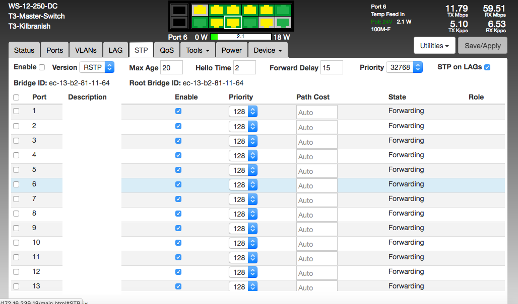

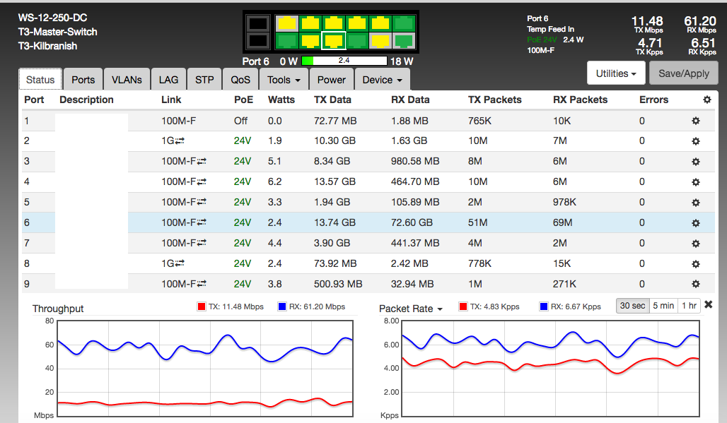

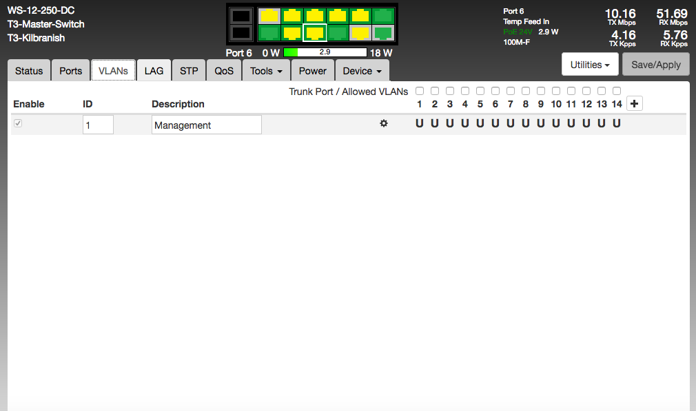

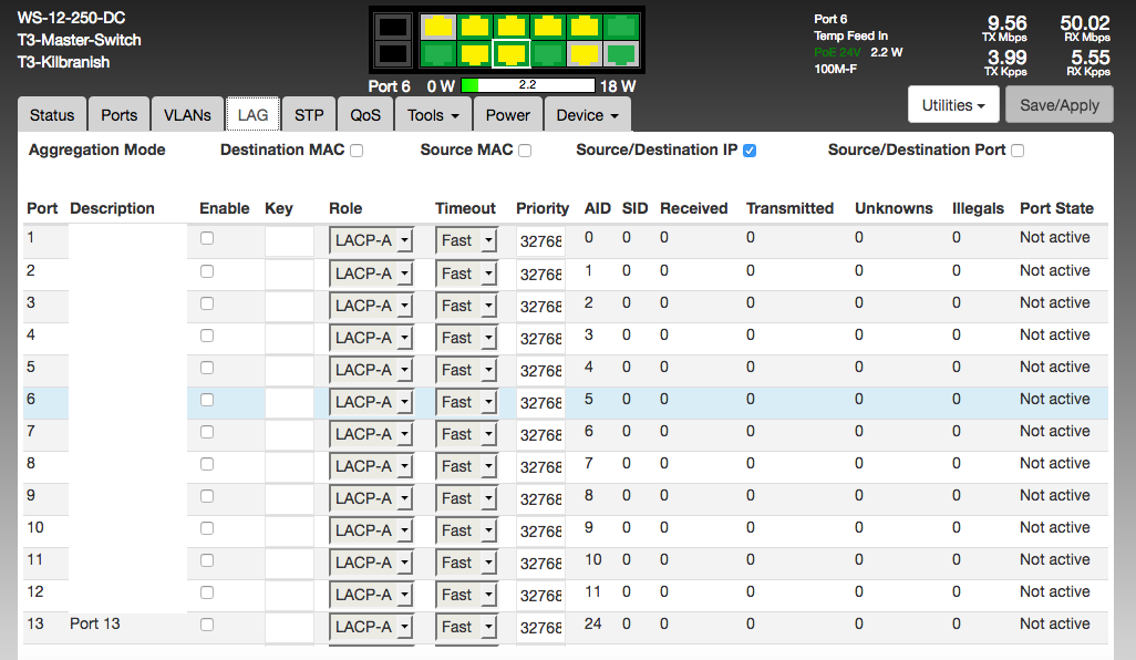

Do you have any VLANs defined, if so please post up a picture of that Tab.
Please post up screen grabs of your Status and Device/Configuration Tabs as well
To upload pictures to your post use the Upload attachment link below the blue submit botton

Yes 48VH
No VLAN's on this link

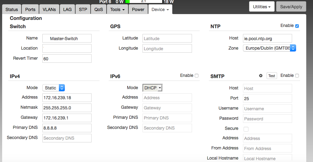

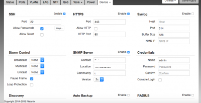

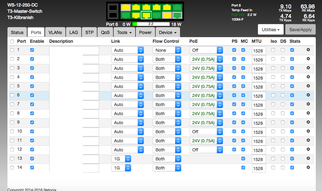

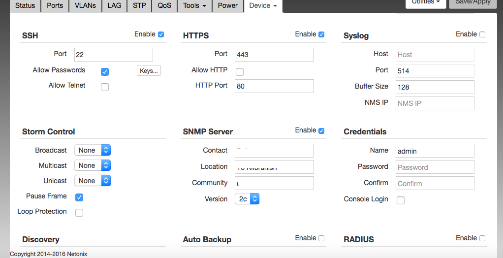

LOL, OK a straight default config
But you forgot the device config file.
No idea in hell why you had issues, makes no sense that you would???
When and if this happens again see if you can SSH into the switch.
Let us know when you try again if you have an issue.
