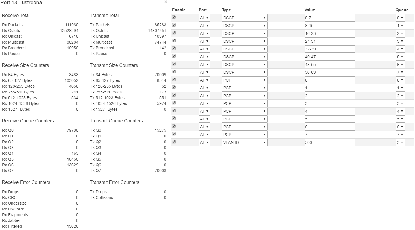

Is there a fix in 1.4.6 for the issue reported for 1.4.5 about the Q7?
IntL-Daniel wrote:
I have upgraded to 1.4.5 from 1.4.4. Previously I had configured QOS port mappings. After the upgrade, all QOS settings were gone and I had to set it again. But before I entered any rule all ports already counted packtes to Q7? For me sounds like the similar bug like previously this "- Fixed utility packets using Tx Q1 instead of Q0" ?

So I decided do a test again. I disabled all QOS rules for Q7, then reset port counters and this is the result 1 minute later (just remeber I am on 1.4.6 and the same was in 1.4.5, not in 1.4.4):

I agree. I have one switch, one uplink, none other ports connected (traffic from and to switch is only management - SNMP, web, ssh and sometimes OSPF hello packet). TX Q7 is big number ... fifth times more than TX Q0. Scheduler is WRR.
RX Q7 is ZERO.

IntL-Daniel wrote:So I decided do a test again. I disabled all QOS rules for Q7, then reset port counters and this is the result 1 minute later (just remeber I am on 1.4.6 and the same was in 1.4.5, not in 1.4.4):
Q7 is used for sending LACP and STP packets to give them the highest priority.

Eric Stern wrote:Q7 is used for sending LACP and STP packets to give them the highest priority.
It's good idea :-) Sorry for bug in my brain ... In my example it is about 1 packet in Q7 per two second.
We have STP and LACP disabled od Netonix and in the whole network but Q7 still counting, is that still correct?
