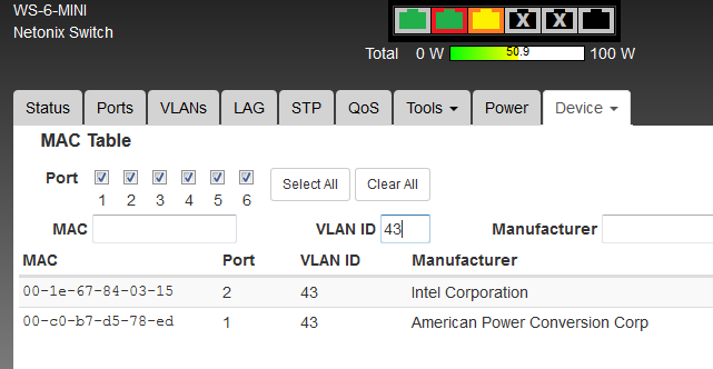

Mini-6, vlan43, sees two devices.

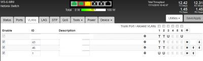

Mini-6 VLAN settings

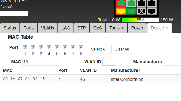

8 port only the locally connected device, not learning anything from its trunk connection with the mini-6

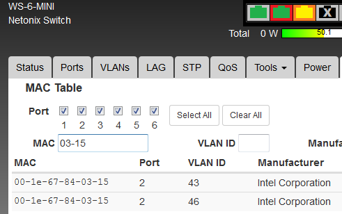

mini-6 one mac two vlans

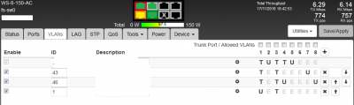

8 port vlan settgins

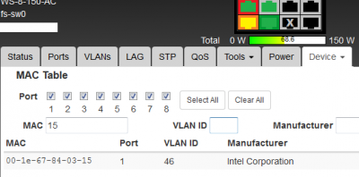

Finally - 8 port has learnt mac in vlan46 (46 and 43 are basically set-up the same)
But the 8 port just see's one.
