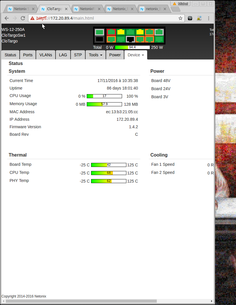

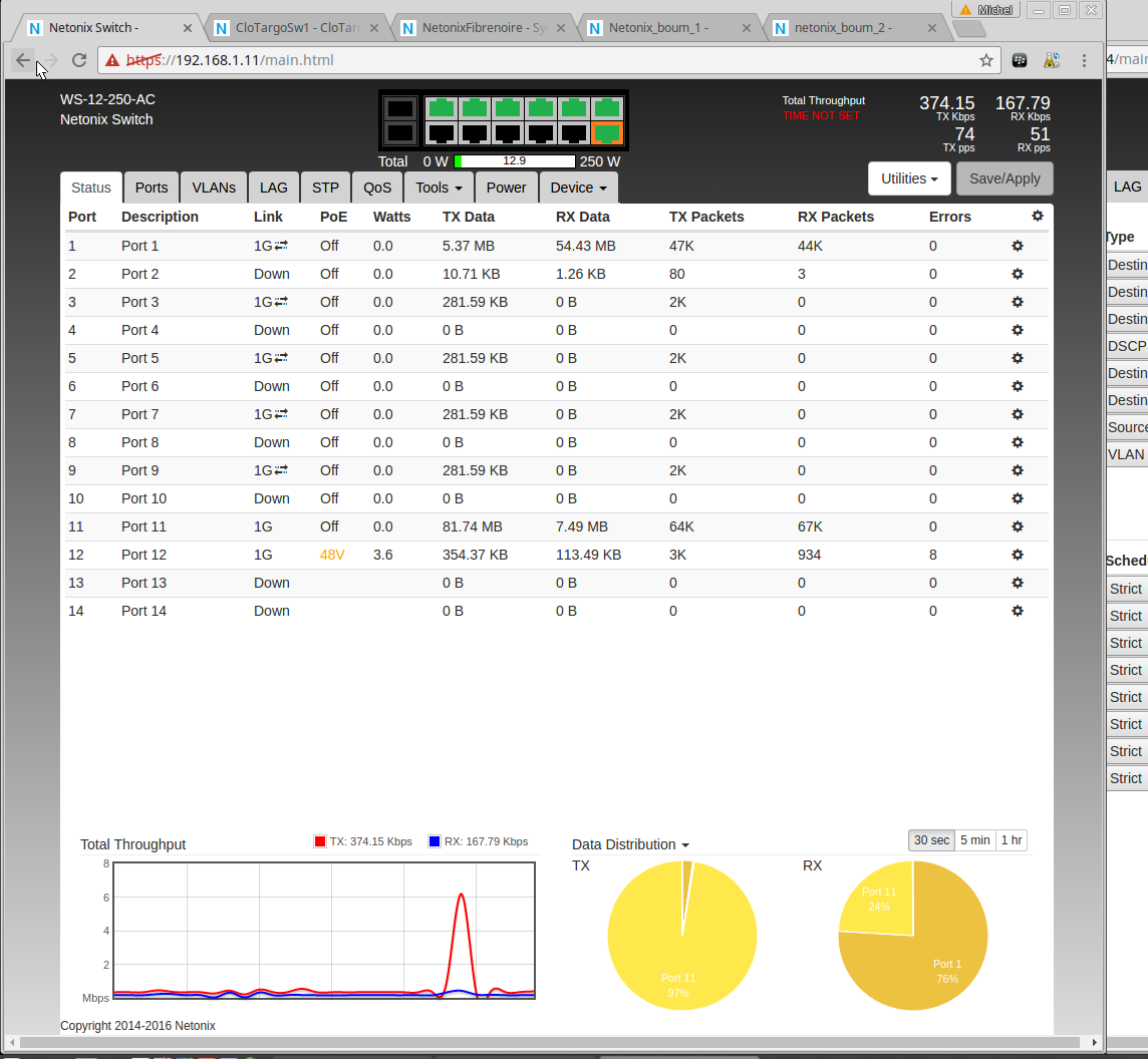

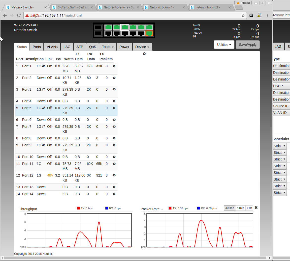

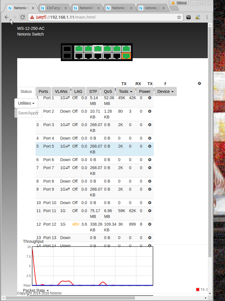

View is broken when using a width less than the with background with Chrome on Linux. I realized it while splitting monitor in half (two windows side by side) on a full HD monitor. That probably related to mobile device view problem. I try several switch with 1.3.7, 1.3.8 and 1.4.2. The 1.4.5 was the only one with this behavior. Yes, I know I should update but we must also not fix what not broken and I didn't really need any feature added since now (QoS) and MSTP comming next.
I added some picture, 1.4.5 at first with large enough width. 1.4.5 view when width of the window is too short, 1.4.5 view that don't came back fine after resing large enough (only the tab that as affect view with behavior like this so if it was to small at status and you resize large enough and move to a other tab, only status will still be wrong, even if you change tab and come back). I also add a picture of 1.4.2 with too short width not affected by the view bug.
Added checkbox to enable and disable QoS rules is a nice option. That will help teest QoS.
Edit: Just saw that resing large the window width large enough fix the view problem most of the time but not alway like shown on attached picture (1.4.5 large enough width after not large enough view bug.PNG). Testing more, it seem like the tab always broke in 2 lines with resising not large enough but the port show won't always beavior the same way. Sometime broke in 2 lines, but most of the time, not.
1.4.2 not affected by too small window width
1.4.5 view bug still happening after resising large enough but only for tabs open while windows width was not large enough.
1.4.5 with width not large enough that trigger view bug
1.4.5 with large enough width before the view bug
