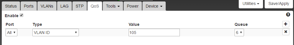

Hello,
Any chance of getting a voice VLAN option added to the switches?
We have VoIP phones installed at some tower sites due to no cell service in the area. This would also allow us to sell Netonix switches with small business VoIP deployments.

Just upgrade to lastest rc firmware and set a queue with higher priority (7 or 6 if you want to leave 7 for network management) by vlan ID and set your voice vlan vlan ID.
Exemple if your voice vlan is vlan id 105 in attachement.
P.S.: Don't forget to check enable at top.
