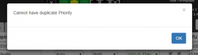

We cannot make any changes to the device due to this error message.
- Error Message

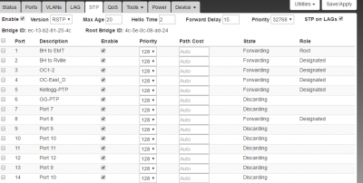

We were thinking it was STP as the priority was listed as the same there, but we received the message even when trying to disable STP.
- STP

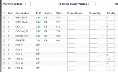

LAG is disabled. The only other priority we can see is power, which is different.
- Power

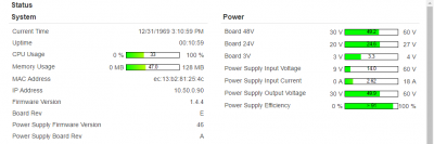

It is currently running 1.4.4.
- Status

That message refers to the priorities on the Power tab. But the priorities on the Power tab look correct. So it must be something else.

The config actually has Priority values for ports 13 and 14 even though they are not shown in the UI. Somehow those values got set to 9 and 10, which are duplicates of the values for port 9 and 10, hence the error.
I'll send you a fixed config.
I'll also change the code so it ignores the values for ports 13 and 14 in the future.
