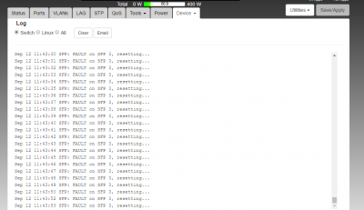

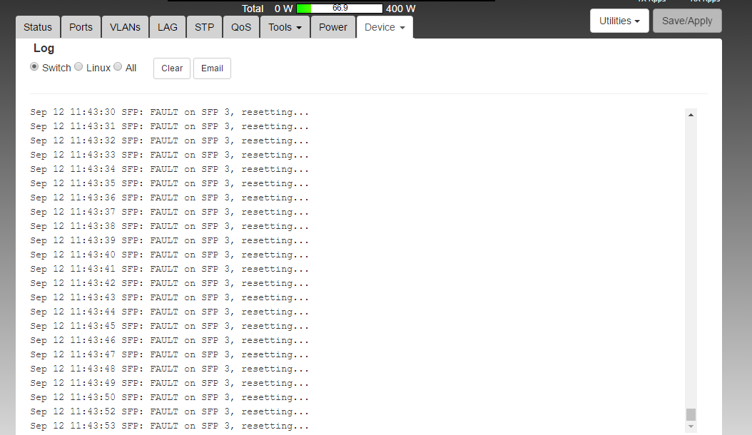

New to the forum so I apologize if this question has already been asked. I couldn't find it using the search. I just upgraded firmware to 1.4.4 on a WS-24-400B and now get a repeated fault message in the log for SFP3 shown below.
Sep 12 11:06:57 SFP: FAULT on SFP 3, resetting...
I do not use the SFP ports on this device. Is there a way to disable the SFP ports? I do not see access to them from the web management interface.

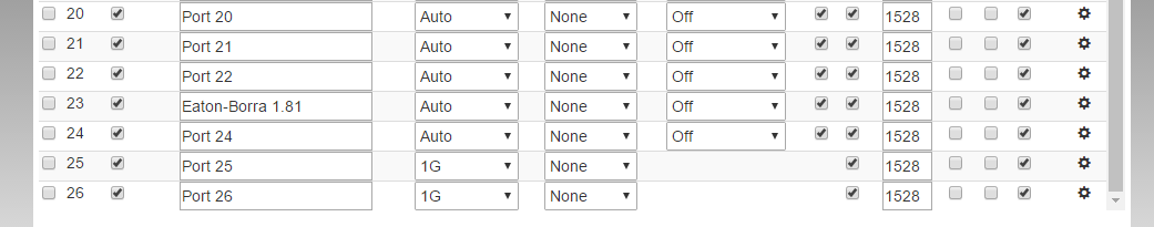

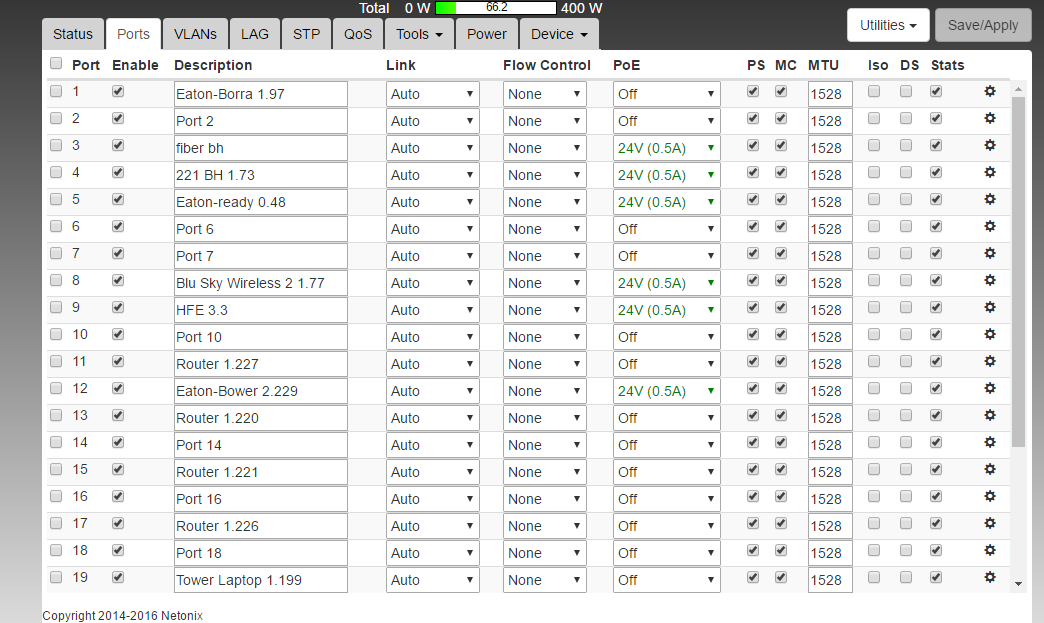

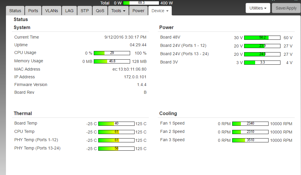

So you are saying you have no SFP module in those ports?
Can you post up screen grabs of the Port Tab, the Device/Status Tab and the Log Tab showing the errors

Re: Fault on SFP3 after upgrading to 1.4.4
Thanks for the reply. That is correct we do not have any SFP modules attached to any of the ports. Below are screen snips from the tabs you requested. I appreciate the help.
The errors cleared after doing a hard reset on the switch. It looks like we are OK for now. I appreciate you looking into it. I had tried disabling ports 25 and 26 prior to the hard reset, but it did not have any effect. Thanks again for following up.

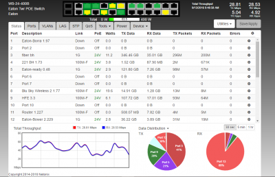

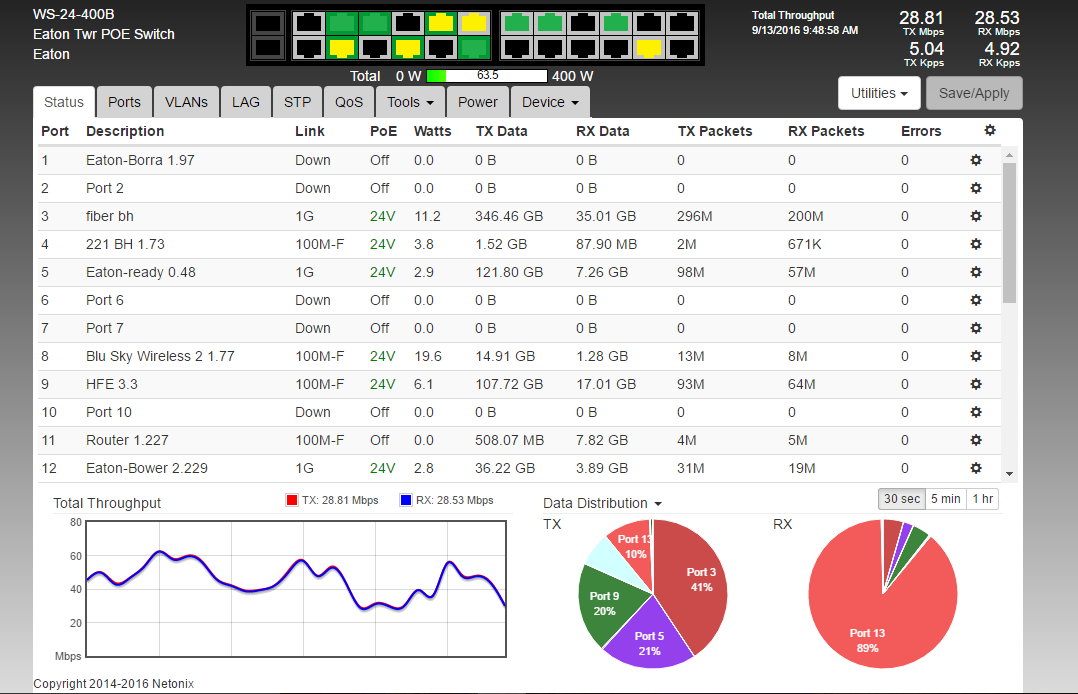

Can you also give me the Main Status Tab but also include the header part.
Main status tab is below. Switch has been running all night and the SFP3 fault reappeared around 9:00 last night. Total uptime before the fault reappeared was approximately 10 hours. I had not seen the fault before the upgrade. With only two SFP ports on the device, am I reading the fault correctly that it is looking for a third SFP port?
Thanks for putting up the Status Tab.
I was looking for possible current sensor damage but all looks good so I am wanting our programmer to do some tests to see if there is a bug in v1.4.4 with the WS-24-400B but he is on vacation until Tomorrow or Thursday.
Is everything working fine for you other than the errors being thrown in the log, meaning can this wait until possibly Thursday?
it does appear to be working, but we are getting some complaints about speed that we weren't before. it is the last device before our edge routers to the internet. i have a spare unit on standby in case ifails completely.
bhicks2000 wrote:it does appear to be working, but we are getting some complaints about speed that we weren't before. it is the last device before our edge routers to the internet. i have a spare unit on standby in case ifails completely.
Thanks!
Those could be coincidental any may not be related? I know it is easy to attribute any new issue to a current problem but I do not "think" they are related.
