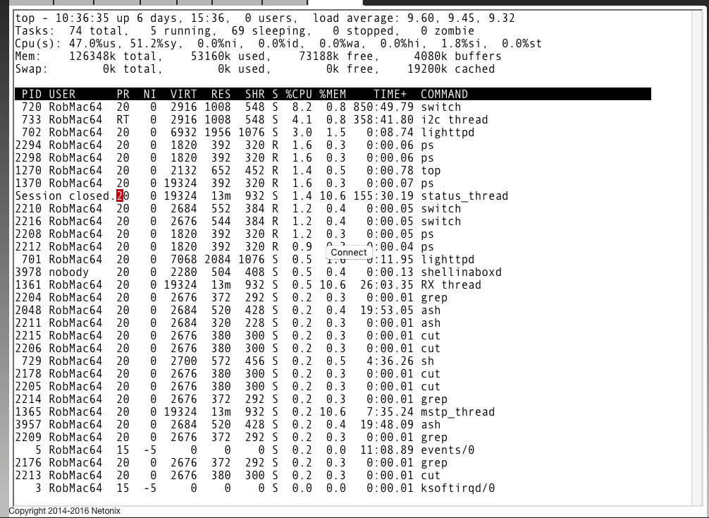

Hear is a screen capture of the unit in question. As far as that segment network, it connects to our core router and handles the distribution there. We replaced the WS-12-250A with the WS-12-400 last week and still the problem is there. We are replacing it with the WS-24-400 today or tomorrow as we need more ports anyway. Thanks so much for looking at this for us...
Re: Constant 95% to100% CPU Usage
I am confused, the CPU is showing 47% in your picture not 90%+ which is normal?????
Also please post up the Device/Status Tab
Also when you first log into a switch a CPU will Spike for awhile as it is busy sending data to your browser but should settle down to 50% or less as a few seconds.
The CPU has nothing to do with capacity of the switch as the CPU your looking at only drives the UI/CLI and runs control Daemons like RSTP, SMTP, LAG, STATS, SNMP, and such which is why you do not want to see it at 90%-100% as it could affect those daemons and cause issues.
Also sometimes after after upgrading to v1.4.4 if have high CPU or something acts weird you should reboot it once more as the previous reboot is handled by the previous firmware version.
Also as I said if after rebooting your CPU does not settle down try disabling the features I suggested in my last post and reboot and let me know.

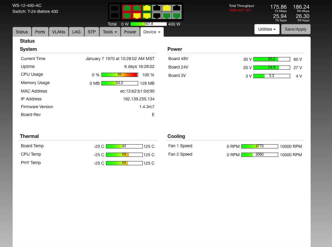

I will do what you suggest and see how things settle down. Here is the screen grab from the "Status" page I was referring to.
Was the Top screen grab and the Device/Console/Top screen grab from the same switch?
Also the Device/Status grab was from v1.4.4, please upgrade to v1.4.4 then reboot after upgrade then try disabling the services I suggested and possibly reboot after they are disabled.

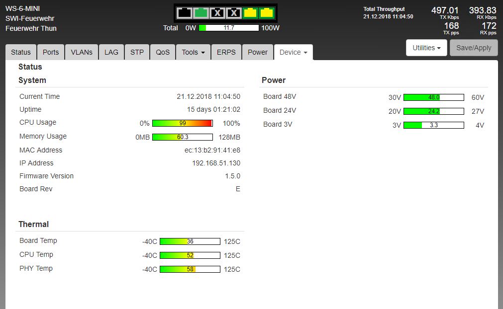

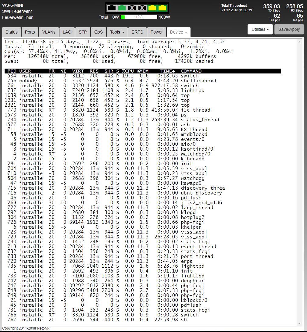

Good day, we have the same problem in one of our networks. The utilization of the responsible process can not be reconstructed via the linuz shell.
Last edited by roman.truog@ict-plus.ch on Wed Jan 09, 2019 3:50 am, edited 1 time in total.
