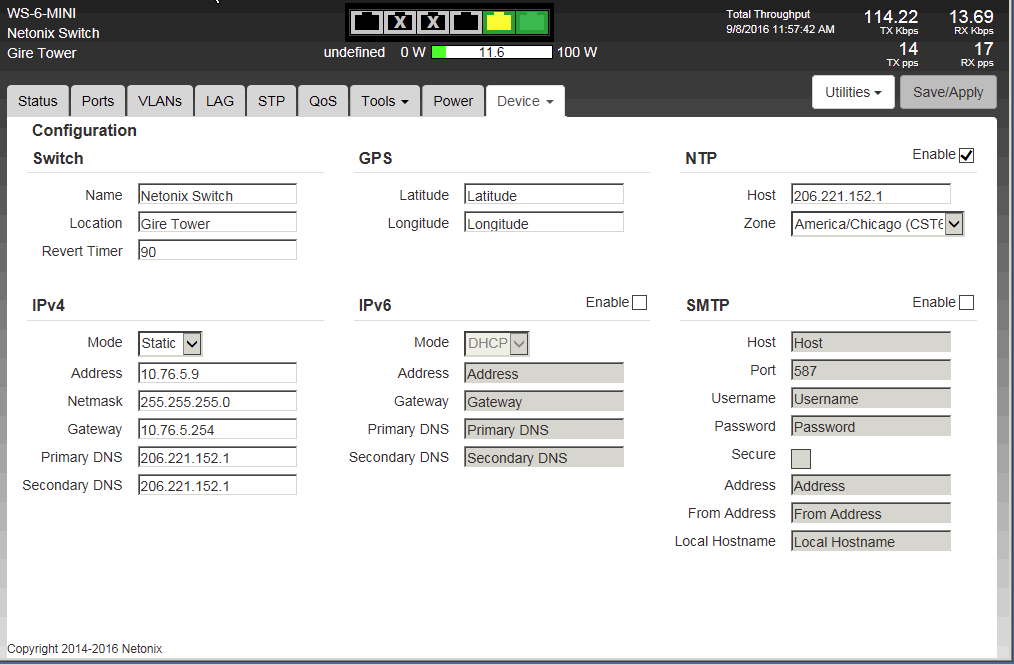

alex.frisbie - Member
- Posts: 4
- Joined: Fri Nov 20, 2015 10:25 am
- Location: Ithaca, NY
Re: v1.4.4 Bug Reports and Comments
sirhc wrote:@Alex
I have been testing Loop Protection here with daisy chained Netonix Switches and do not see any issue.
Could you post up the Config Tabs of the switch that was giving you the issue and maybe explain the network topography around that switch.
Is it part of a larger flat Layer 2 segment or routed?
Do you have a lot of VLANs? (a screen shot of your VLAN tab would help)
Chris,
We don't really use anything on the Switches at all besides PoE, haha. It looks like in this scenario, loop protection was enabled for some reason on certain switches. Normally, we don't use loop protection. However, with that being said, loop protection on these switches was enabled and they were running 1.4.2rc4, I believe. I upgraded them all to 1.4.4 and it seemed they started to throw fits. All of the loop protection detections were on ports running Ubiquiti Antennas that were setup on a PtMP network. The only thing plugged into the majority of the switches that gave me problems is one camera and one Ubiquiti antenna. I ended up rolling back to 1.3.7rc6 on 6 of them at this location.. the other 3 I haven't been able to get into yet. It seems they're still passing data, as I have camera footage at the locations the switches are at, but I can't find them in a Ubiquiti scan nor can I login to them.
Also, out of curiosity, did you guys ever find a problem with Flow Control? I've been disabling flow control on switches we've been putting out. There definitely was a problem on the initial 1.4.2. After I disabled Flow Control everything was fine on the switch I had a problem with prior. Once again, that switch was only sending camera data to a Ubiquiti antenna back to a centralized location.
P.S. There's no VLANs setup there at all.
This is a configuration from one of the switches that I rolled back to 1.3.7rc6.

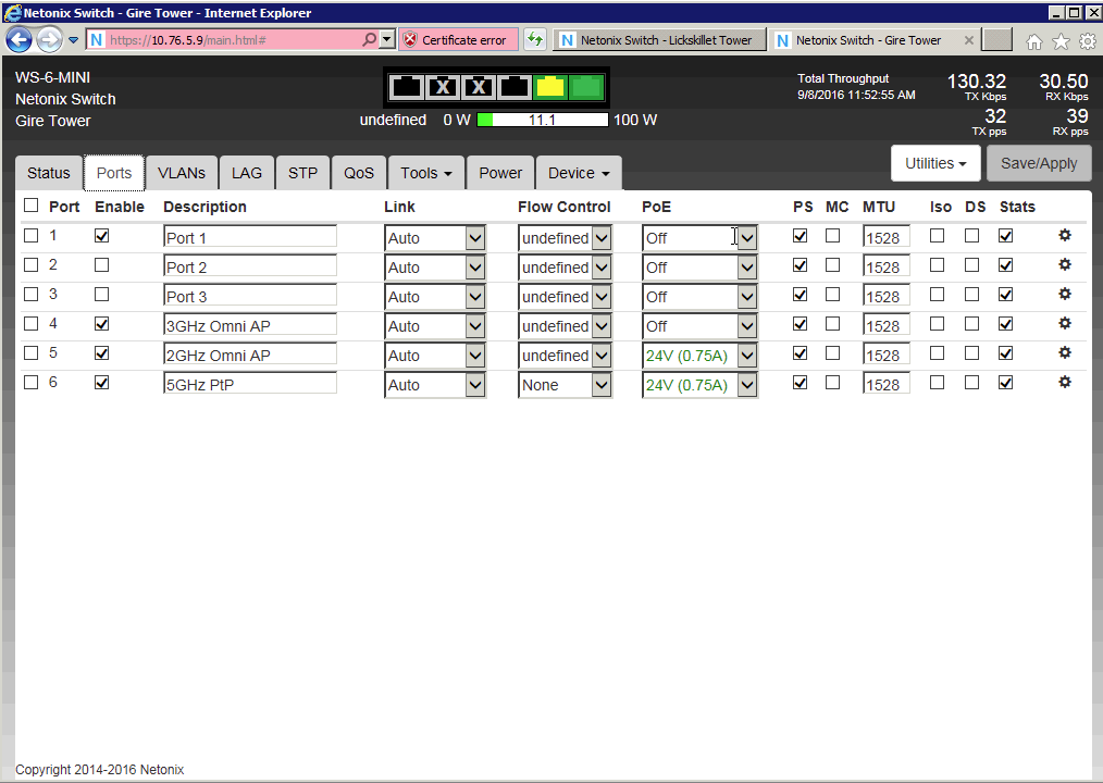

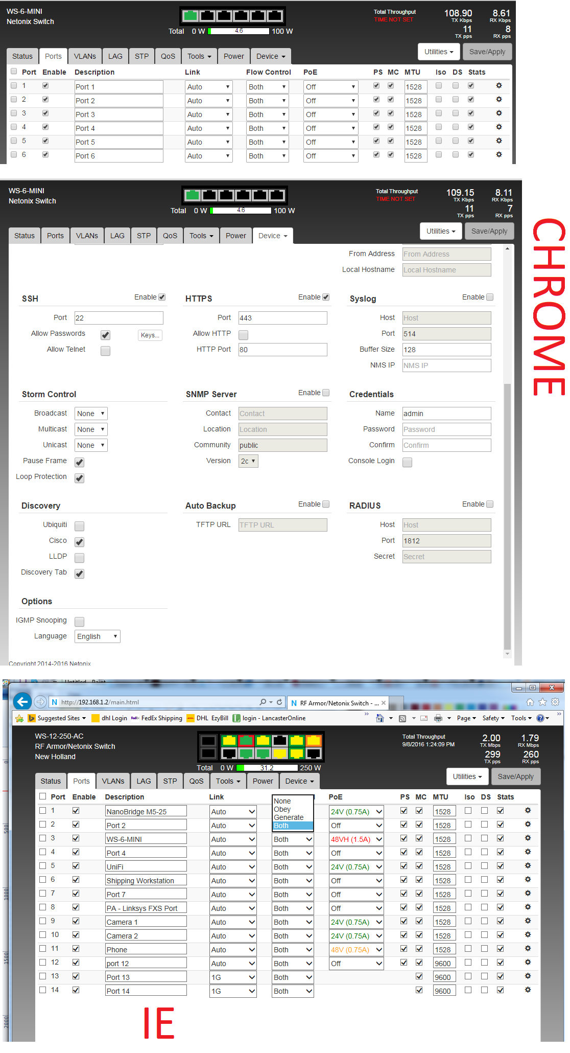

upgraded from 1.4.3 to 1.4.4 and now I have some:
1: "undefined" issues under Flow Control options. (not sure if this is expected)
2: Missing options under Device -> Configuration. no ssh, no https, no syslog, no storm control, no snmp server, no credentials
What version of IE are you using?
If you use Chrome what happens?
I am running v1.4.4 and I do not have this issue?
IE version: 11.0.9600.18426
Update version: 11.0.34
