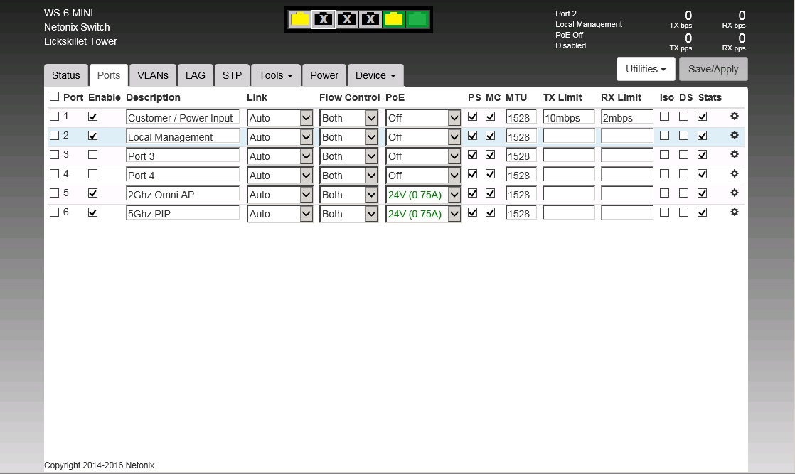

I'm attempting to "enable" port 2 on this switch, I can't get the web gui display to show it is enabled.

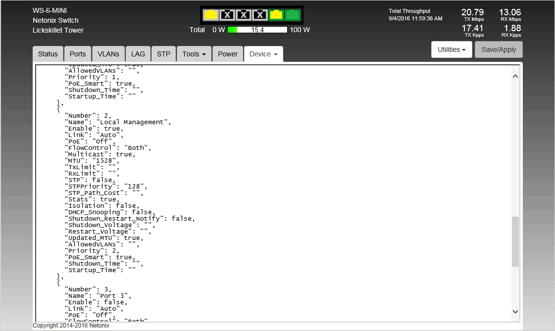

I've enabled the port on the port page, and confirmed that the port is enabled in the configuration via the console "show status" command.
However, I can not get an Ethernet link. The GUI still shows it's disabled.
can't enable port
