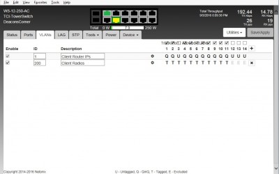

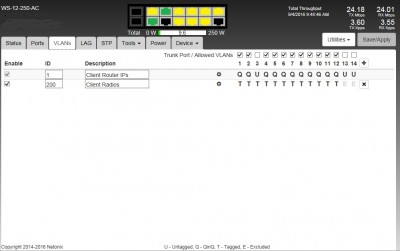

So a simple VLAN 200 would solve my problem. This way I could rename the current default mgt VLAN 1 as Client IPs and add VLAN 200 as Client Radios VLAN and assign the range 172.24.200.2/24 with 255.255.255.0 subnet to it. Example; This way I could re-configure Client 1 Radio 172.24.199.101 to be Client 1 Radio 172.24.200.100 and Client 1 Router stays at 172.24.199.100

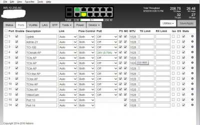

What browser are you using causing your VLAN Tab header to be messed up like that?
Why you do have Trunk Port checked for all those ports, are you passing any other VLANs other than 200?
Why do you have Qs on your Default VLAN?

I'm using IE 11 it's only sometime that happens.
No, right now I'm not passing any vlans to those ports. I was trying to get vlan Trucked over to those ports in my testing. What should they be? The Q's was the only way that I could get a test Radio and AP to work with vlan 200 so I could try configuring Radio's & AP's on the 172.24.200.0/24 and leave the clients router ip's at the 172.24.199.0/24
The only problem I was having was once I got the an AP & a Radio to work on vlan 200 - 172.24.200.0/24 was that the AP & Radios could not talk to NTP to update to the correct date/time.
