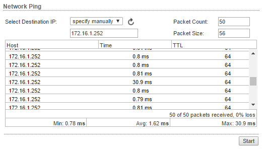

Background: running 1.4.3rc7. The symptom is that pings from, to and across the switch have occasional 100ms+ times and packet loss (e.g. 3 failures in 50 pings) when typical time would be less than 4 ms. The problem seems to be independent of enabling/disabling flow control, VLANS and individual ports. All cable diagnostics are good (can’t test some radios). The problem is the same for 1.4.2. The amount of packet loss and the length of the delay seems to be directly proportional to total traffic.

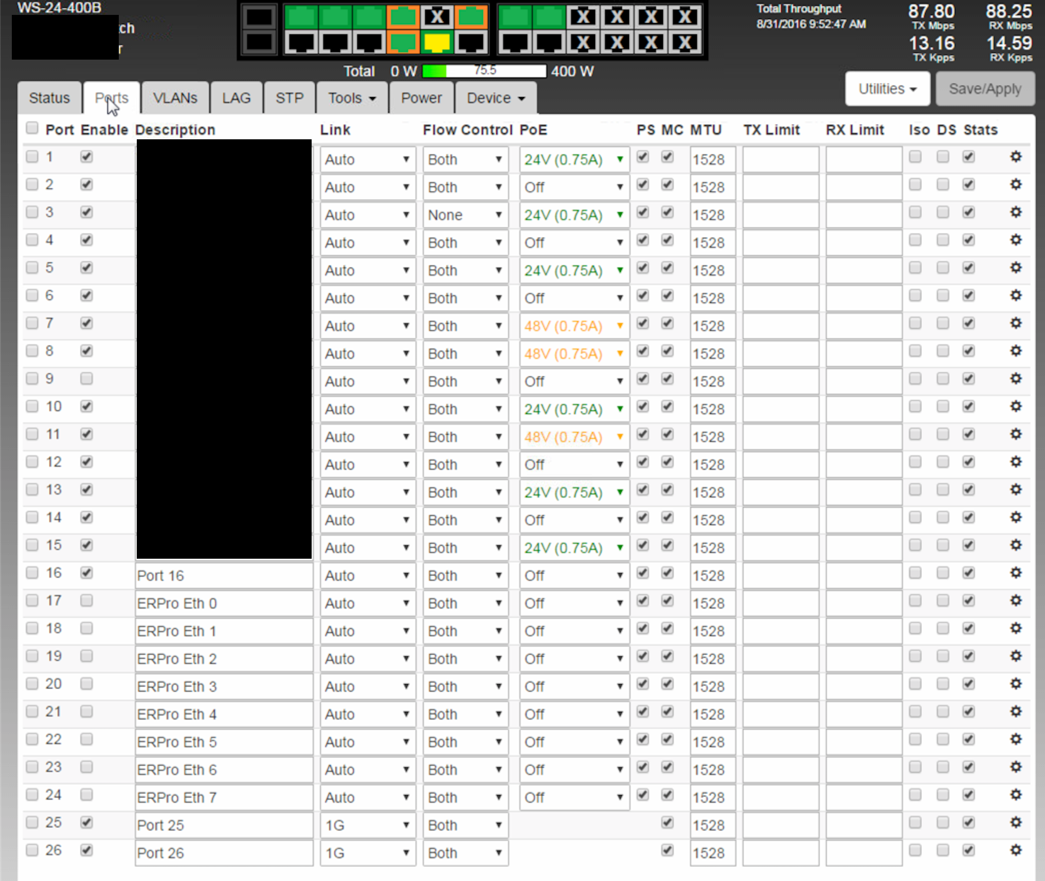

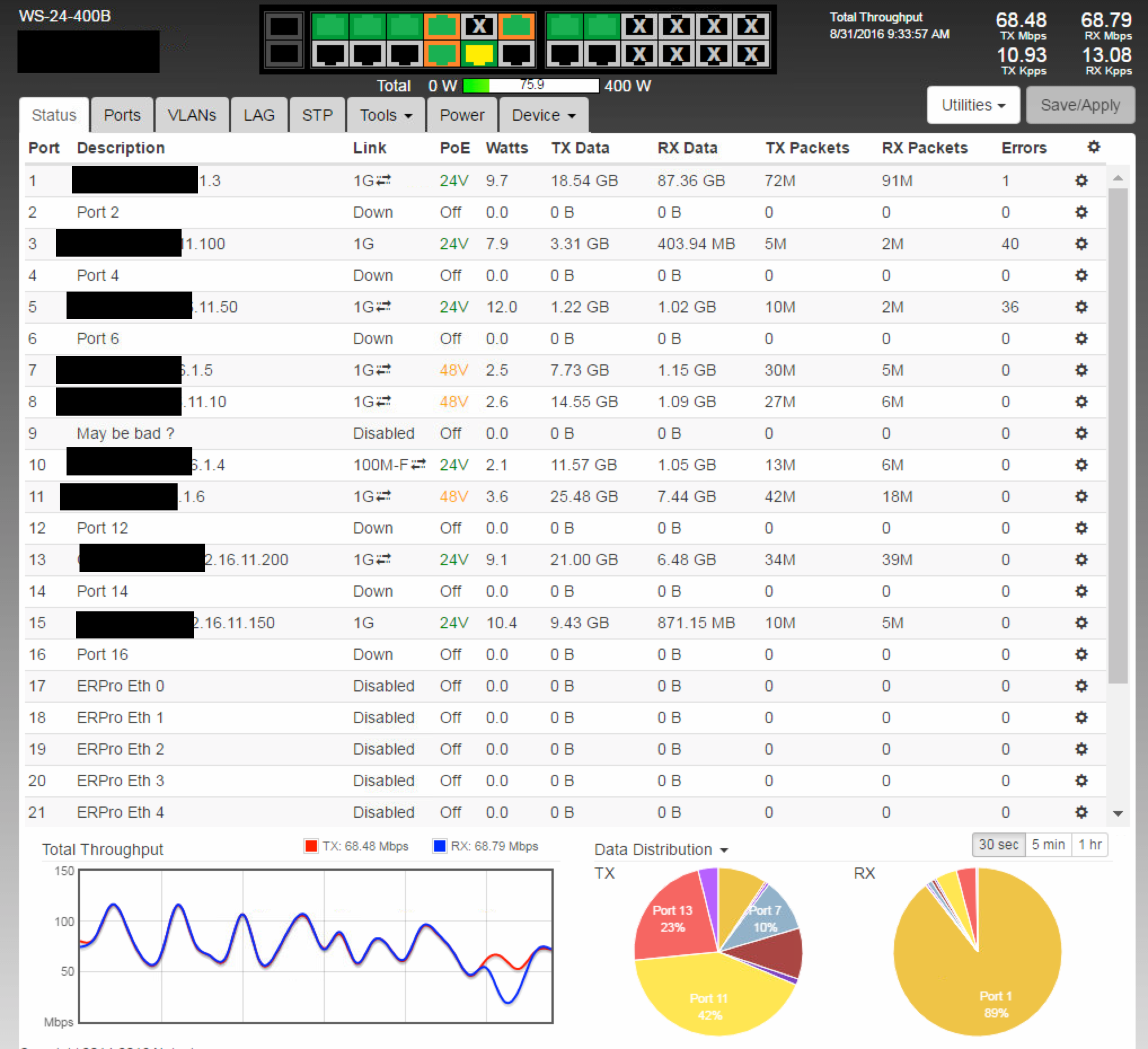

Ports 1, 3 and 5 are AF5X. Ports 13, 15 are Rocket AC. Ports 7, 8, and 11 are Rocket Ti. Port 10 is a Rocket M.

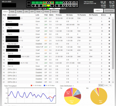

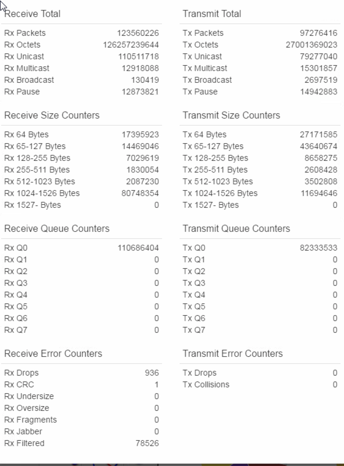

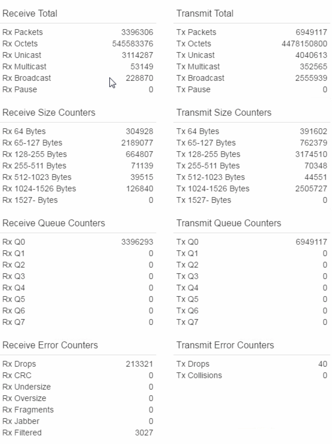

Can you post up Port Stats on any ports with Errors.
Also maybe a network diagram so I know what is on what port and going where.
Was this current configuration working without issue before storm or was changes made after?

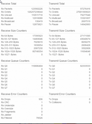

Port Details for Port 3 and Port 1 attached. Port 1 is the one with pause frames. In terms of network diagram, port 1 is backhaul, the rest are AP's to customers. On the other end of the backhaul is another Netonix ws-24.

You're getting a lot of Drops on those ports?

Also if ports 1,3,5 are AFX radios you should check and see if they are the newer models that can take 48VH
Read this post to find out: viewtopic.php?f=6&t=1215#p9040
If these AF5X radios will take 48VH you should use 48VH but if you have no 48VH port available then use 48V over 24V
