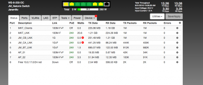

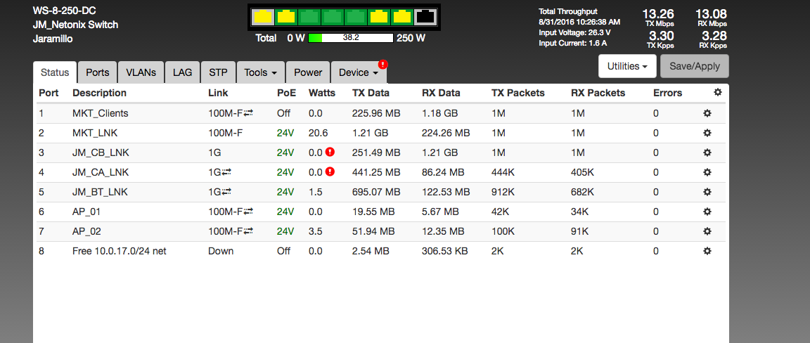

We had a power supply fail and after recovering, we now are getting this error on 2 ports:
Aug 31 10:03:29 switch[1368]: Port 3: PoE is enabled and port has link, power should not be 0
You can see by the attached screen shot, we actually have 3 ports with POE turned on and the switch is showing 0 watts but the radios are powered and up.
I upgraded the switch to the latest RC 1.4.3rc7
All seems to be working OK, but we continue to get the red alerts?
Thx

Hi dave,
I am guessing your power supply died from a surge or ground potential shift as some of the port's current sensors are obviously damaged as well and now no longer report wattage.
So the switch is confused wondering why POE is ON if there is no current being used.
Looks like sensors on ports 3, 4, and maybe 6 are damaged?
viewtopic.php?f=30&t=1816
viewtopic.php?f=30&t=188
viewtopic.php?f=30&t=1429
