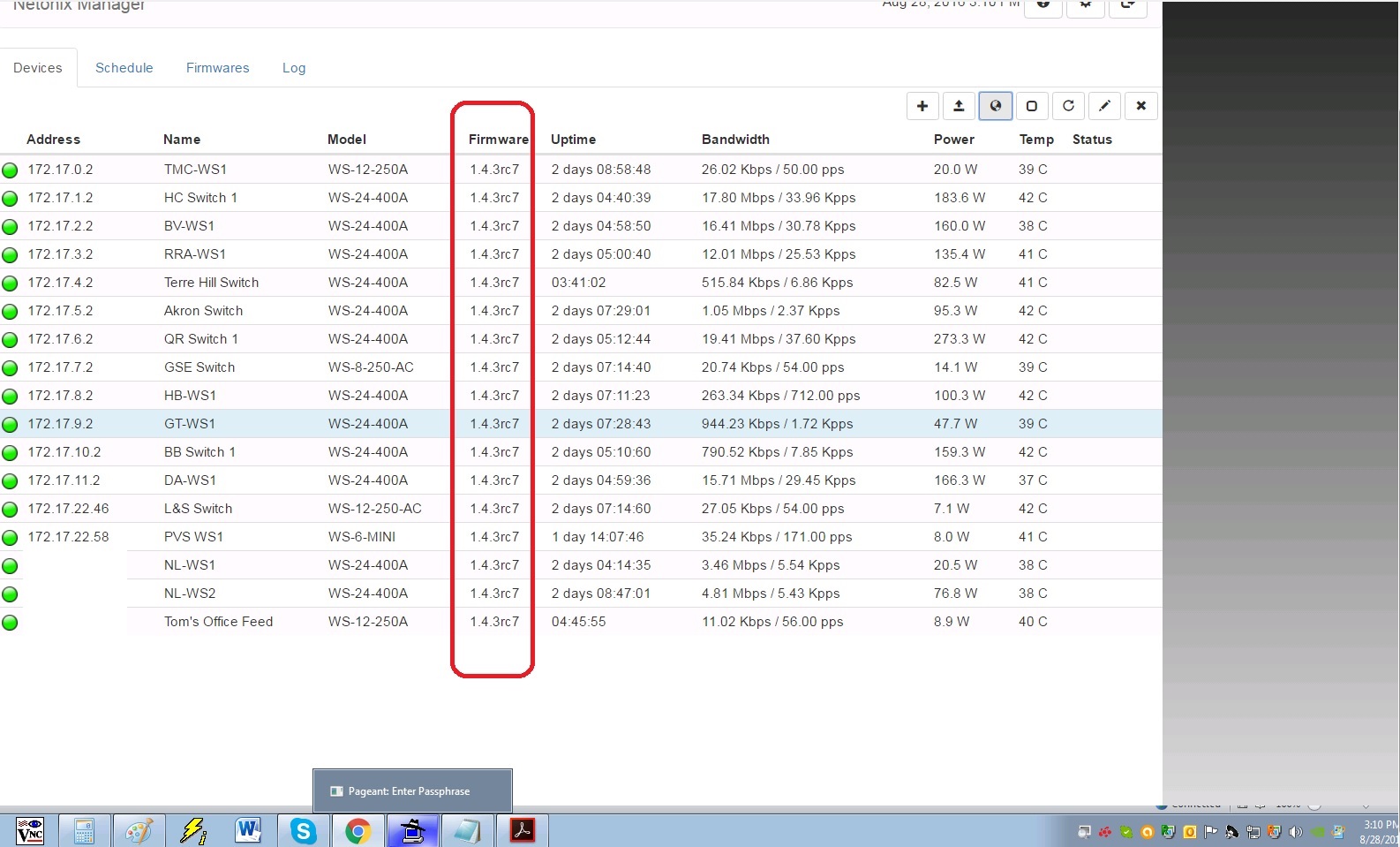

But as I say read release notes and see if anything NEW AND BIG was added or simply mostly bug fixes which is what v1.4.3rc7 is
Re: Switch stopped passing traffic by AC2 discovery scanning
Look, I am a WISP as well so if there is something to be concerned about I would not recommend using an RC version without warning you something is NEW and untested but when the RC version is mostly fixes and small insignificant new features I will suggest using the RC version.
As I said I am a WISP as well and never recommend using something I myself am not using.
If I take the time to send out a PM alert that means I am worried about you otherwise I just post the new RC version and let you decide. WHen I send out a PM Alert there is good reason. Now you have to decide if me knowing the ins and outs of what is going on with the firmware should you heed my warning?
