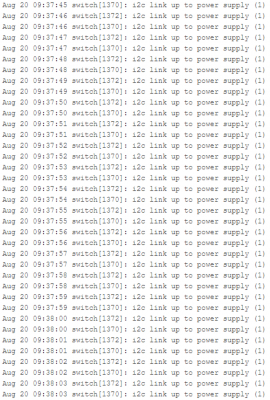

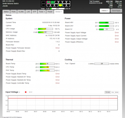

Please see attachment for details. We moved a solar system from 24V to 12V and this problem occured. The first time, we thought we messed up the swith somehow (Board Rev F ) but put in a new switch with Rev E and got the same thing. I really like to be able to remotely log in and check battery health via the Input Voltage chart - thank you for that feature.
WS-12-250-DC Power Supply Firmware Error

hmmm, this is implying that the I2C connection between the power supply & the main board isn't working at all, or a lot of RF (FM maybe) interference.
but you said you changed from a 24 to 12 volt configuration & this occurred....that doesn't make sense...can you go back to the 24 volt configuration & retry?
please also try latest rc release if you can.
Re: WS-12-250-DC Power Supply Firmware Error
The first one being rev F should have been immune to FM band RF. My guess is the 12V source is too noisy for even rev F. How is this wired? Usually the batteries act as huge filter capacitors squelching the noise.

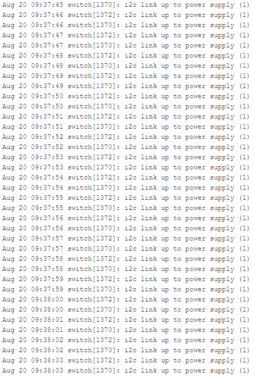

No improvement with latest RC release but log file is active .... see attachment.
