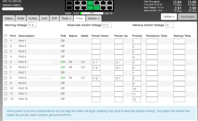

Well my "guess" since you have not provided any information to draw any definitive conclusions would be the input voltage dropped below the hibernate voltage which the default lowest is 9V.
How many batteries are powering the switch?
What model batteries are they?
How are the batteries connected together (series or parallel)?
What is charging the batteries?

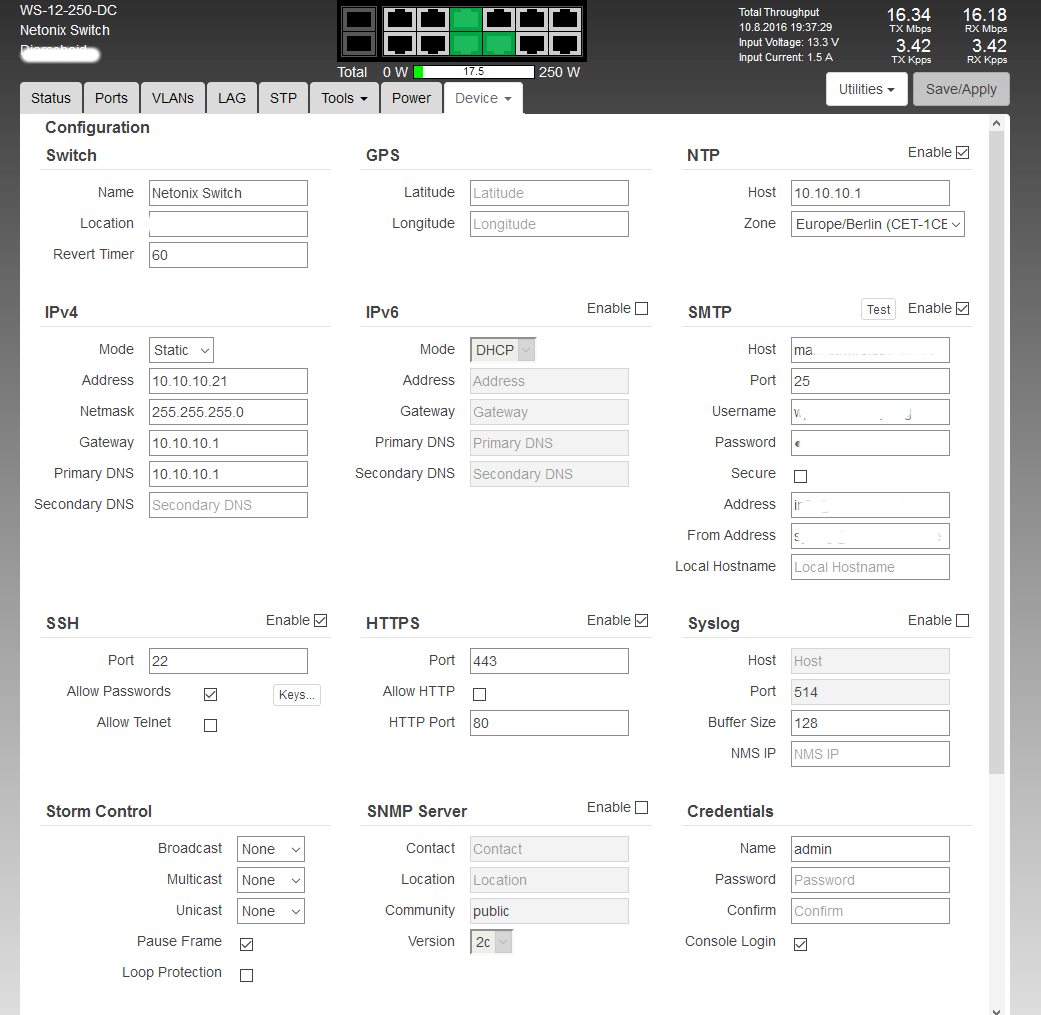

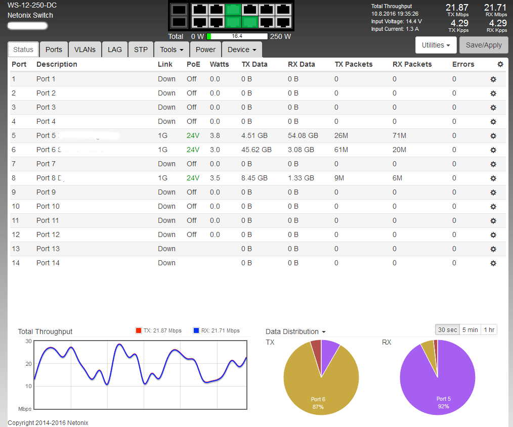

Post up pictures (screen grabs) of the the following Tabs:
Status
Power
Device/Status
Device/Configuration

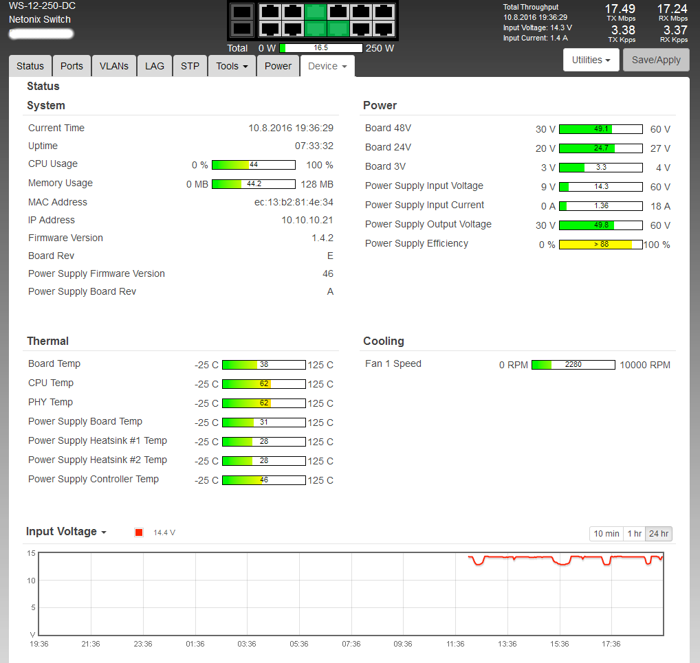

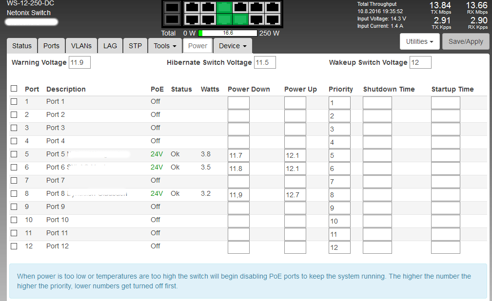

Hi,
here are the Pictures:
Voltage is never under 12,4 V, the switch rebooted today with fully charged Battery
Battery is 12v 150 AH VARTA DEEP CYCLE AGM
Solar is
6x 180WP Solar Pannel connected to
EP Solar ET-6415 Solar MPPT Tracker

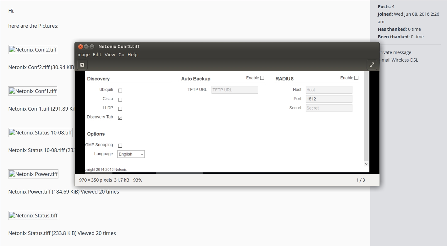

Solar is
mistry7

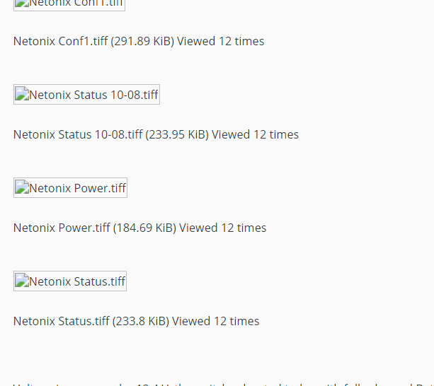

Re: WS-12-250 DC Log Message Cold Boot
Can not see your picture.
You need to upload the pictures.
look at the link below the blue buttons that says upload attachment
Go back and edit your post and upload the attachments (read the instructions on the screen where you create your post)
Wireless-DSL wrote:over people can see, the pictures are viewed 10 times
No they are seeing the icon in place of the pictures.
I can not see them and no one else can.
You need to upload them to the forums so other people can see them
Below is what other people see, I would not say so unless it was so.
I did Upload the pictures!
Why i Can See them on all my devices
And you not?
And you not?
Maybe because they are .tif
Can you edit your above post and post them as .png format?
I cannot see them inline either, probably cuz they are in tiff format. I can download the pic and see it that way.
