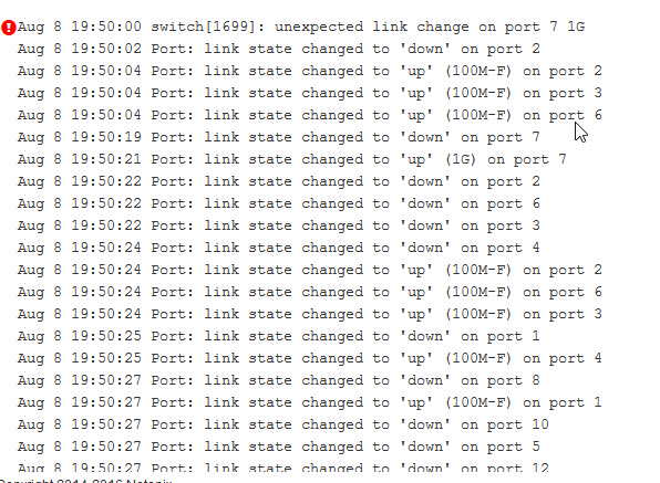

I am not touching the switch and i keep getting my rocket M5 radios and other equipment going off and on.
This is the log.
Any reason????? Firmware 1.4.2
Port Link changed down / Up

Well I have manged to find out when it happens but i do not know why.
If i leave everything then there is no problems log stays clear no link state change evey thing is up.
I checked all my cables with a network tester they all show the same db, no shorts and a pass on all.
Even though i get some message about bad cable or end when everything passes on the network tester.
This is when the problem happens.
AirControl2 / Discover / IP-Range Scan / Scan 10.1.1.0/24 / then most of the ports that are powering the rocket m5s changed to red.
If i just dicovery broadcast everything is fine.
So i dont know if scanning an IP range is making the APs reboot or scanning an ip range is making the switch ports reboot???

nightshadow36 wrote:Well I have manged to find out when it happens but i do not know why.
When AirControl2 / Discover / IP-Range Scan / Scan 10.1.1.0/24 / then most of the ports that are powering the rocket m5s changed to red.
If I do just a discovery broadcast everything is fine.
So I don't know if scanning an IP range is making the APs reboot or scanning an IP range is making the switch ports reboot???
That is an interesting question, could you turn POE OFF on a couple ports and use the POE bricks and then do the same scan. If the ports with the POE brick still go red then you know the POE is not being turned OFF.
I am not sure how the scan could affect the switch in anyway but I am always open to verification.

Issue went away when i turned off UBNT discovery
Re: Port Link changed down / Up
nightshadow36 wrote:Issue went away when i turned off UBNT discovery
Try v1.4.3rc5 and see if you can leave UBNT Discovery on then.
