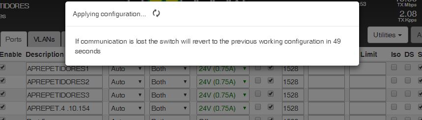

I have recently upgraded to firmware 1.4.2 one WS-12-250AC, and after update I change the description of one port, using dots (.) in it.

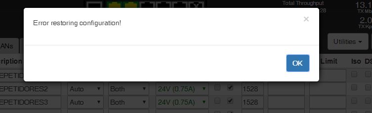

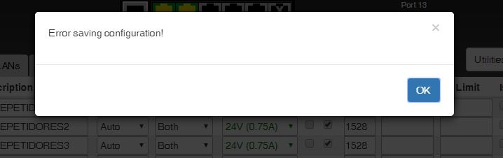

After this change I'm unable to change any parameter of the configuration. Always an error is returned. Restore config and/or downgrade neither works properly.
Always after 60 secs. countdown...
Or restoring
Some suggestion? I need to recover switch control without a factory reset.

Problem solved!! Thanks to everybody!!
Finally, the problem was not related to port's renaming description, but SMTP config.
Sorry for the wrong diagnostic. Please consider to delete this forum thread if neccesary, to avoid confusions to other users.
Re: Problem after Port Description renaming
Posted: Thu Aug 11, 2016 7:49 am
Thanks for getting back to us.
We are fixing the code/firmware to better deal with mis-configured SMTP and or loss or poor communications to mail servers so it does not mess up the switch.
I think we have it fixed in v1.4.3rc4 and newer?
