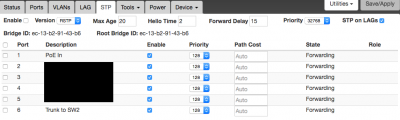

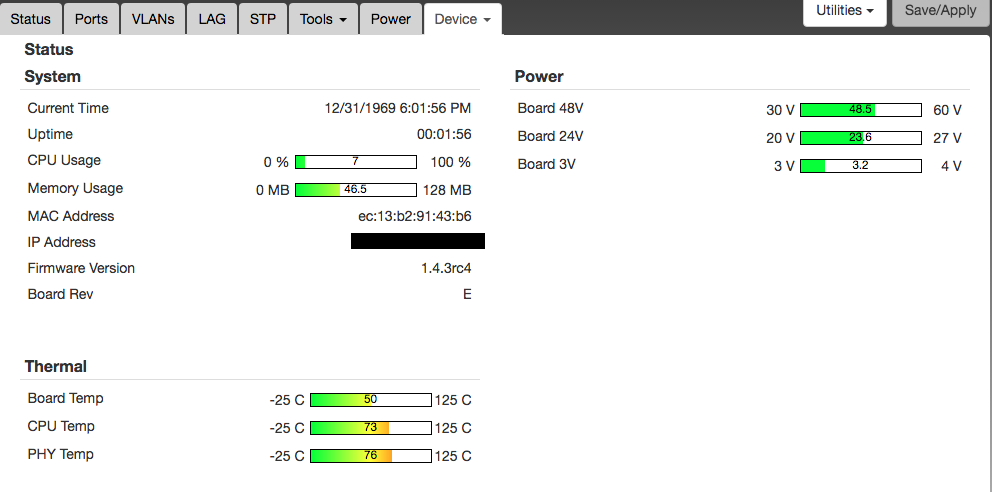

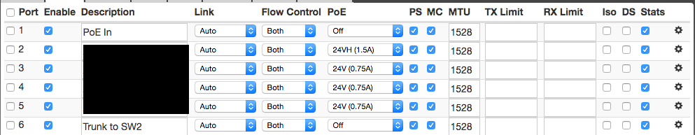

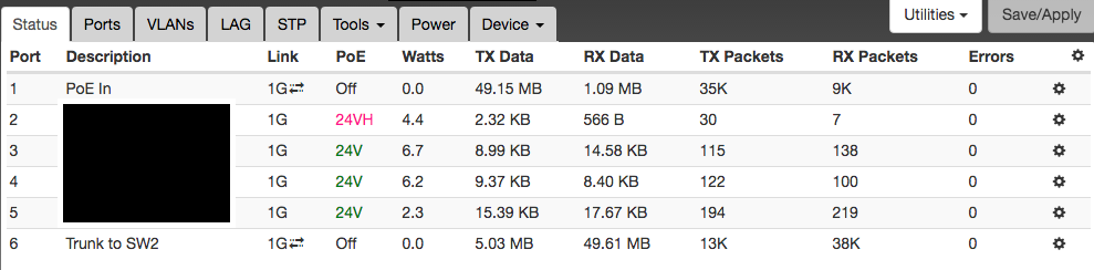

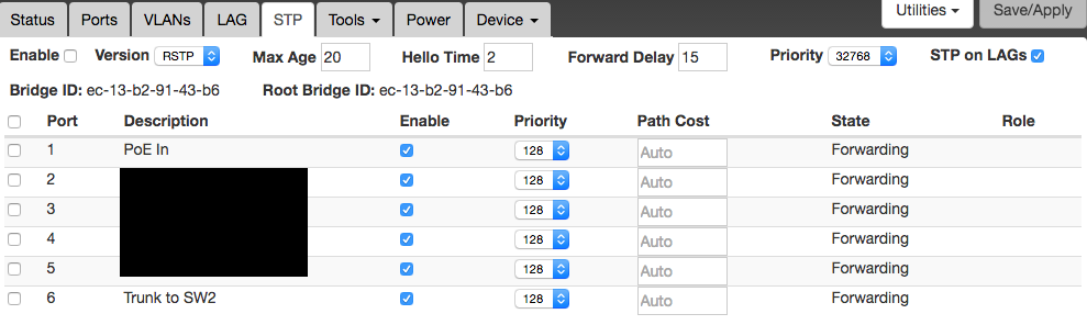

Here are the images.

Frank
This thing is running at a low board temp for this design, so issue is not over heating for sure, and your POE loads are minimal.
Something else must be going on.
I will let Chris comment later when he gets a chance.
