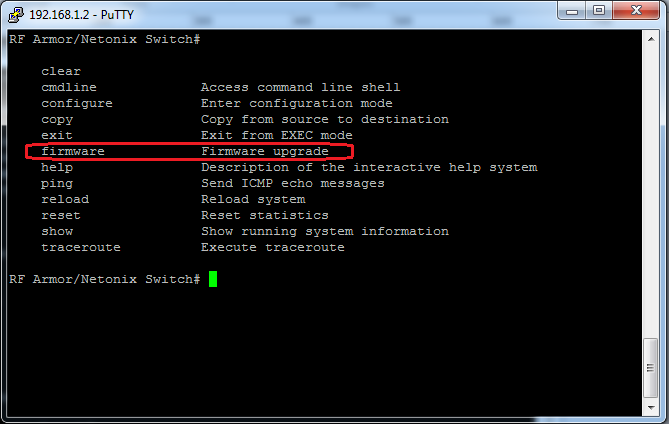

Re: Web GUI not working
To upgrade the switch via SSH requires a TFTP server.
Simply log into the CLI and hit the ?
Next then follow the bouncing ball.
However if your config is corrupted you are better to factory default it and set it back up.
