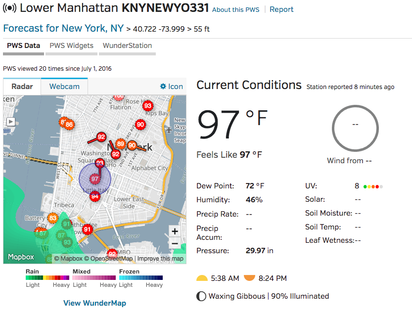

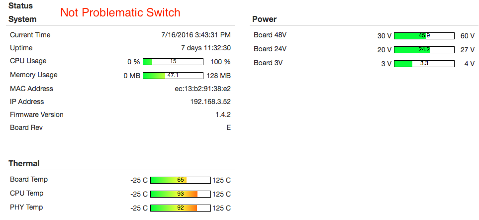

My non-tech colleague is 100% sure it's the heat, just because of the timing. I'm a bit less sure since all the units are within a few blocks of each other in the same (recommended) outdoor case. The others have also recorded higher temperatures.
misbehaving switch
good switch
Right now, it is sweltering, a personal weather station within a few blocks is reading 97F.
weather
Been thanked: 1362 times
Re: Another mystery freak out and reboot
Sat Jul 16, 2016 4:06 pm
Those temps your showing are fine for the WS-6
But what I said was swap the switch first and if the new switch is still doing this then it has to be something else like a radio or grounding or power or something.
Just because the radios are NEW does not mean there is not a bad one that is using too much power which is what another person found out.
Wish I could find his post but he swapped out a NEW PowerBeam I think and the problem went away.
But I agree swap the switch first to eliminate the switch then go from there.
