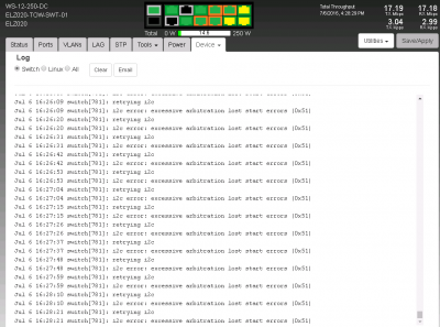

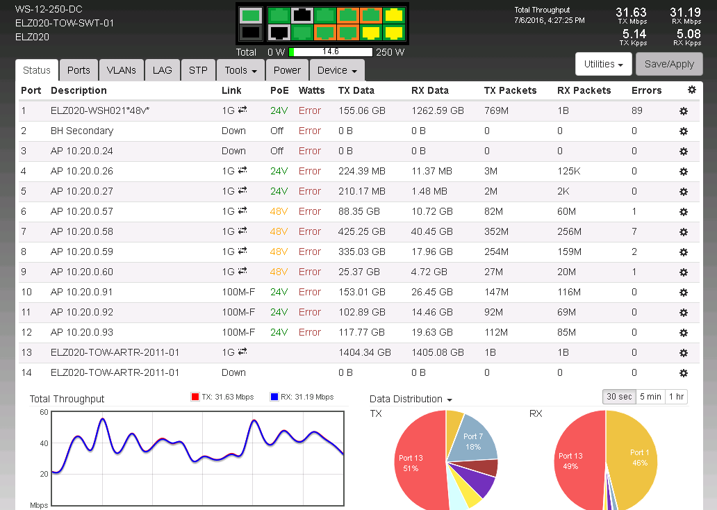

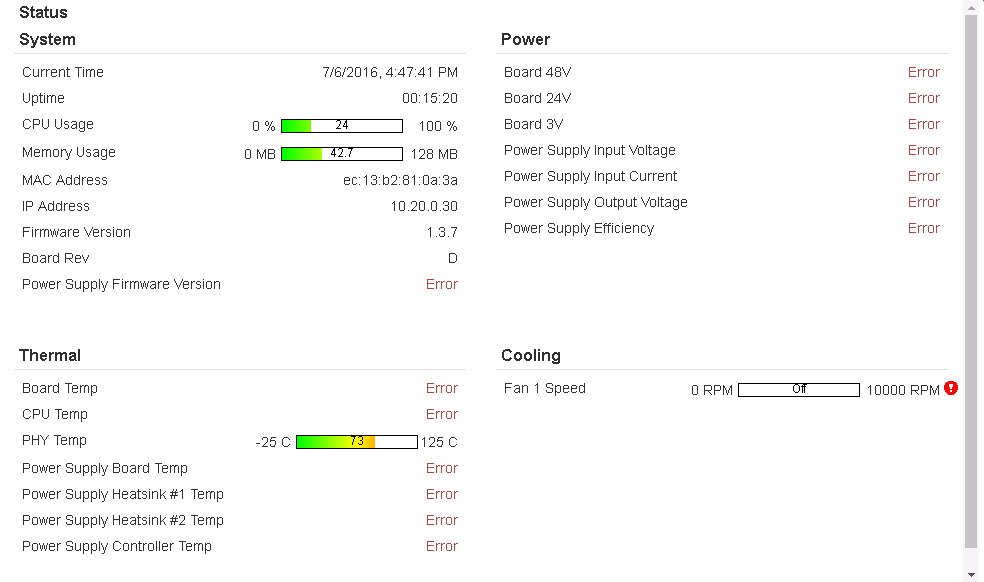

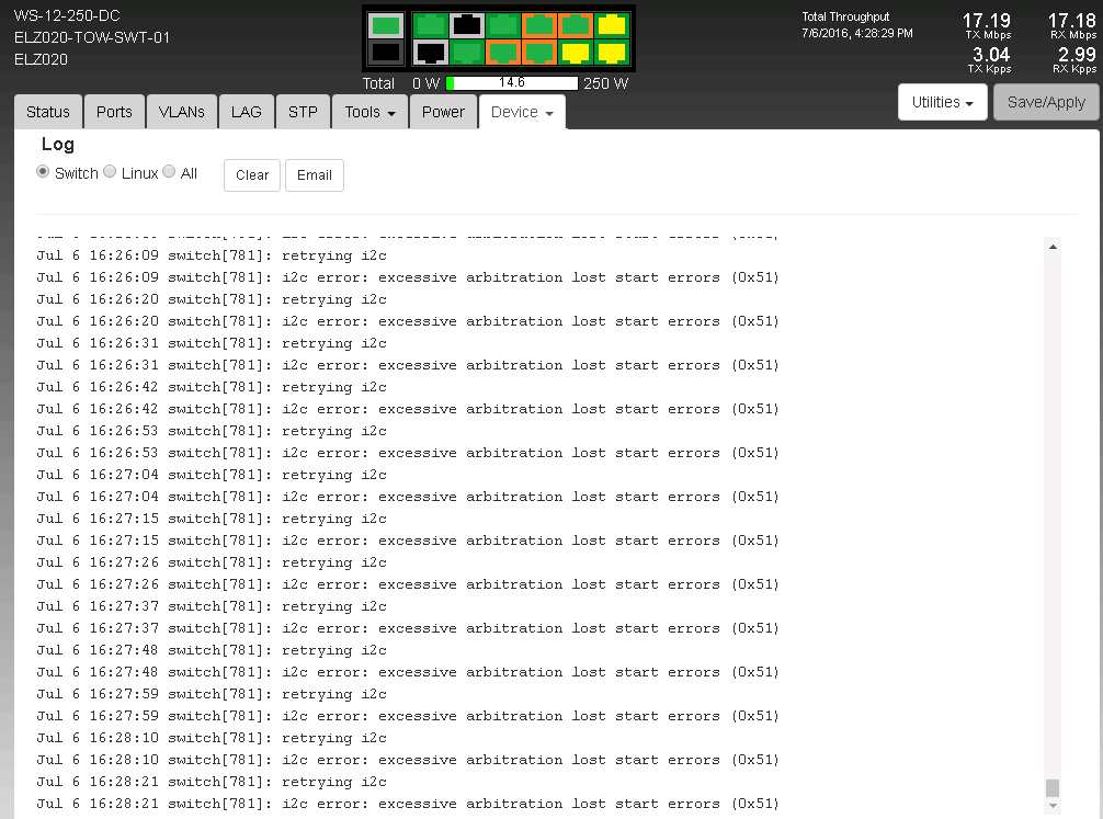

We have a WS-12-250-DC running 1.3.7 that just started 'freaking' out (see attached logs/screenshots). Several 'i2c' errors and other errors as well (see logs). In this state, the switch was still forwarding packets, but interface errors started to increment (at least on the UI) once this started happening. We typically see 0 errors on all interfaces.
Screenshots also attached as well as a full log after a warm (remote) reboot. The errors and everything persist after the warm reboot. The switch appeared to have recovered after a cold reboot.
Has anyone seen this? At this point, I'm thinking it may be due to a power event at the site? This particular site has an AC UPS and a DC power supply. We use this same setup at several of our sites with these switches. The switch is getting +48VDC. It had been running fine for over a week until this event.
i2c errors

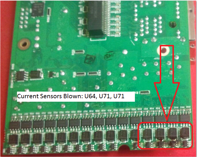

These are the specs on your switch:
MAC Address: EC:13:B2:81:0A:3A
Power Supply SN: 144952-0321
Switch Board SN: 145337-0408
Manufacturing Date: 09/29/2015
First remove the unit from service and test it back at your shop on the bench but my guess is it will not do any differently as far as reporting sensor telemetry.
If it does not act differently on bench then I give you permission to open this unit up and remove the switch board and take picture of the front and back of the switch board and post them up here.
My guess is you will see damage similar as seen below:

Re: i2c errors
Now if your power source did malfunction and sent a surge of greater than 80V even for a second it would have blown out a current sensor which depending on how it blows out the sensor it can cause the entire I2C bus to fail which means all sensors would report ERROR.
Now in the new Rev F boards we put in protection DIODE circuits to protect the sensors from excessive voltages out of the speced range in hopes to prevent this type of damage from excessive surges as we had several people report that their off grid chargers malfunctioned and sent 80V+ to the batteries for what ever reason bowing out the sensors.
Now keep in mind the sensors are rated to 80V and we only originally spec'd this unit to accept 9V-60V then later 62V with a firmware upgrade.
We are now shipping with Rev F Switch Boards and DC2DC Power Supply Rev B where we allow 9V-72V which is still below the rated voltage of the sensors we use.
We could not use higher rated sensors and still be anywhere near accurate at lower voltages/current that we use.
