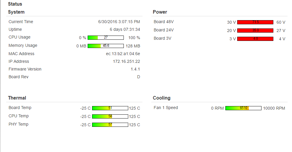

Have a tower with a WS-12-DC which is showing super high voltages, but AirFiber and Rockets ok? How bad is this issue, or is it bad reporting in firmware?
Re: Hot Netonix WS-12-DC?!
I am going to "guess" your switch took a hit and damaged some of the current sensors.
Throw up a screen grab of your main status Tab, I bet some of the current readings are wrong.

Either that or you sent the switch way more than 48V DC.
What is powering it?
Is it possible you're overdriving the switch?

No, powered by a Meanwell 48VDC Din rail unit. Use them elsewhere. No surges have taken place to our knowledge. It is a fairly new unit. Have at least one person reporting same thing on a port on WISPA member list.
wispitgood wrote:No, powered by a Meanwell 48VDC Din rail unit. Use them elsewhere. No surges have taken place to our knowledge. It is a fairly new unit. Have at least one person reporting same thing on a port on WISPA member list.
Please post up a screen grab of the main Status Tab
