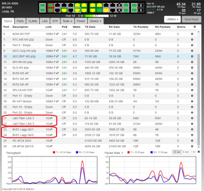

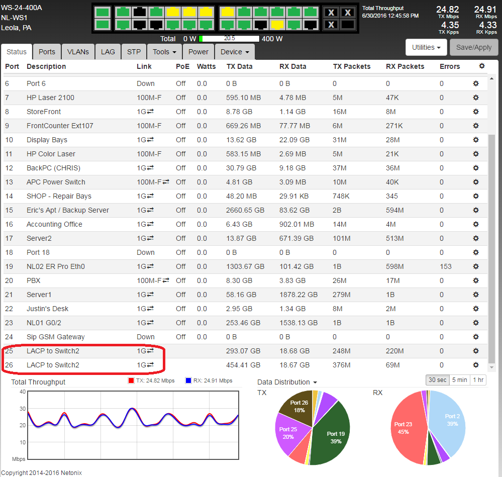

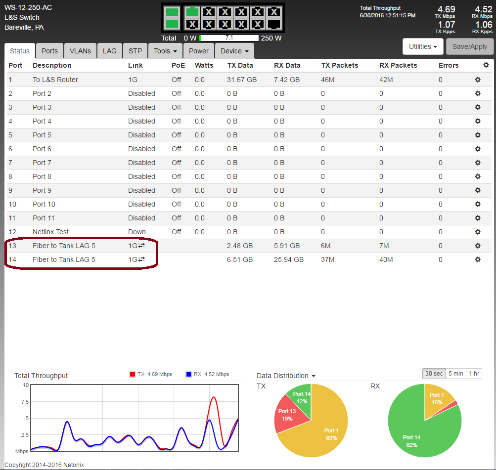

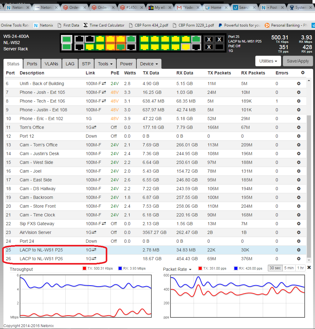

I have no Idea, I have many WISP Switches connected together some even with LAGs and Flow Control is active on all of them?
Now maybe if you have an AF radio on one switch that generates a Pause Frame Storm to the switch it can eventually cause that switch to send out tons of Tx Pause Frames on all other ports when the buffers become full.
Here are 3 screen grabs of 3 switches with Flow Control going between WISP Switches
Picture 1 and 2 are 2 switches in my NOX that are tied together
Picture 3 is a tower switch that feeds a FIBER LACP LAG to as WS-12-250-AC for a high end customer
Picture 4 is the WS-12-250-AC at high end customer
