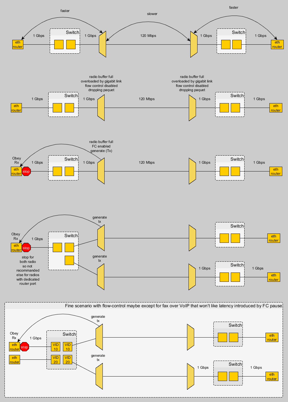

Here a diagram of how it work. Hope it's help.

Re: New Flow Control Settings
Thanks mike, that helps. The router is edgemax.

Unless I missed something, Edgerouter standard line don't support flow control since the Cavium ASIC don't support it.
Edgerouter X line support it but it's a single ether behind a managed switch. A pause frame would block traffic on all edgerouter X ports just like in the section 4 of the image.

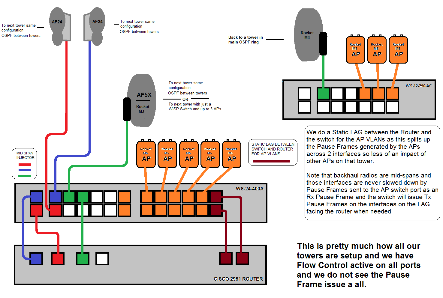

Which is why I never have a backhaul radio share an interface driving local radios.
Instead I use the switch as a midspan injector and each backhaul has its own port in the tower router.
Then I use a STATIC LAG to supply all switch ports to each AP or local PTP for a high end customer.
This way Pause frames from local radios are spread across 2 interfaces and never affect traffic that is transient through the tower to the next tower.
CLICK PICTURE BELOW TO VIEW FULL SIZE
