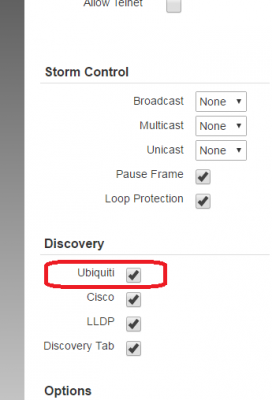

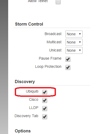

Go under the Device/Configuration Tab and Disable UBNT Discovery and see if that allows you to enable RSTP again and let me know.
We have been looking into this with another user but they did not get back to us to see if it was fixed for them but we had to finalize v1.4.2 for production.

UBNT has not been turned on, on this device. It is currently OFF.
Re: WS-12-250-DC - LVD - Will not power back on Automaticall
Thu Jun 16, 2016 5:49 pm
Nick-ZetaBroadband wrote:UBNT has not been turned on, on this device. It is currently OFF.
Not the Discovery Tab just the UBNT discovery Protocol as seen in red below
