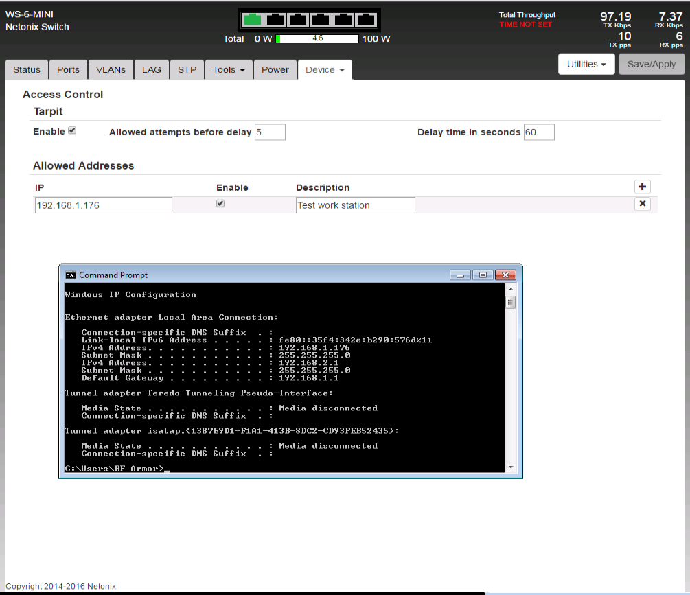

As you can see in the picture below I told the switch that only my workststation could talk to it and it worked and only the one computer could access the switch UI/CLI.

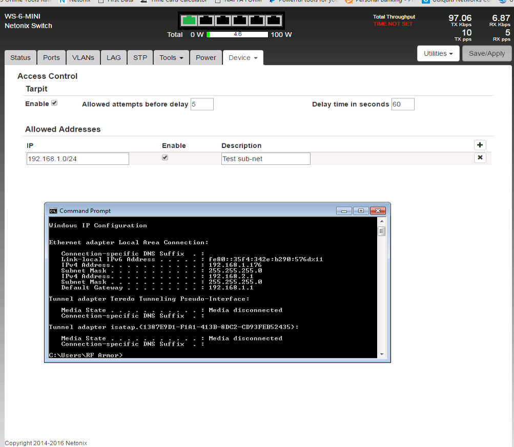

In this picture I told it the whole 192.168.1.0/24 sub-net in the office could talk to it and I could access the switch from any workstation in the office.
Can not help you without more information but it appears to work fine for me?
