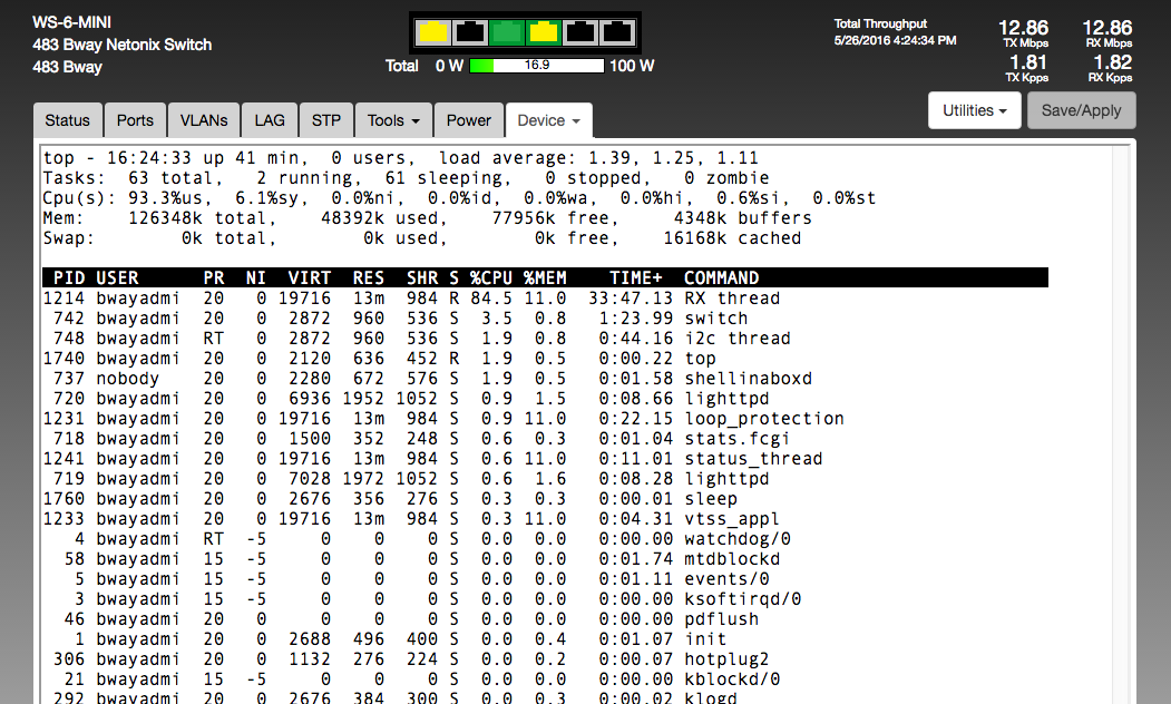

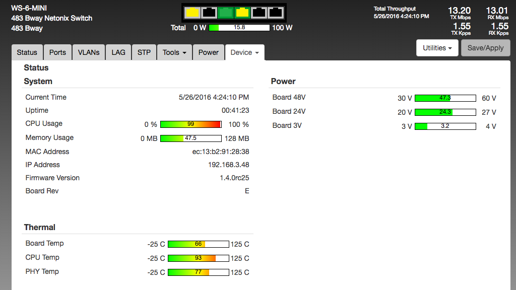

After the reboot, the switch seems to be working, but the "RX Thread" process is gobbling from 80-100% CPU. This unit will get an upgrade late tonight, but I'd like to know if anyone has seen this behavior and what it might be (bug vs. some ubnt gear freaking out). It's pretty lightly loaded - one link down to a cisco switch, one link to an AP with 1 customer, one link to another AP with 3 customers.
See attached pics for cpu usage snapshot.

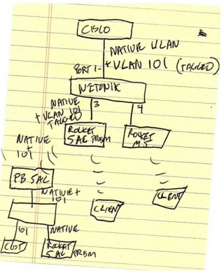

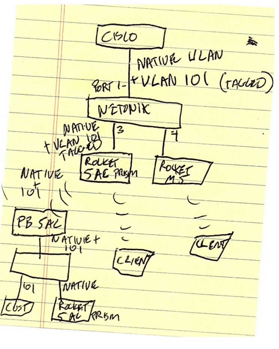

So if I turn off discovery, then one of my APs (Rocket 5AC Prism) stops working unless I turn off STP. So that's interesting. Attaching a rough diagram, but in summary:
Cisco 3550 with a native VLAN and VLAN 101 on the port that goes to the problematic WS-6-Mini
On that Mini:
Port 1 to the cisco, with the Mini set to have VLAN 1 untagged, VLAN 101 tagged
Port 3 to Rocket 5AC Prism in bridge mode with mgmt IP in VLAN 1, also with VLAN 1 untagged and VLAN 101 tagged
Port 4 to Rocket M5 in bridge mode with mgmt IP in VLAN 1, VLAN 1 untagged
The Rocket M5 only has one client associated. The client CPE is in router mode with a mgmt IP in the same subnet as all other devices above.
The Rocket 5AC has VLAN 1 and VLAN 101 each with their own bridge with WLAN and LAN bridged (not to each other, the Rocket is just bridging tagged 101 and untagged 1).
There is a Nanobeam AC associated with that, also in router mode with a management IP in the same subnet as all other devices above.
There is also a PowerBeam AC associated with the Rocket 5AC. It bridges VLAN 1 and VLAN 101 and is connected to another WS-6-Mini.
The WS-6-Mini has VLAN 1 untagged and VLAN 101 tagged on port 3.
Port 1 has VLAN 101 untagged and a customer has a single device (Fortinet FW) plugged in there. The port is limited to 20/20.
Port 4 has another Rocket 5AC Prism. It's in bridge mode, no VLANs and has no clients associated with it.
So that's the topology...

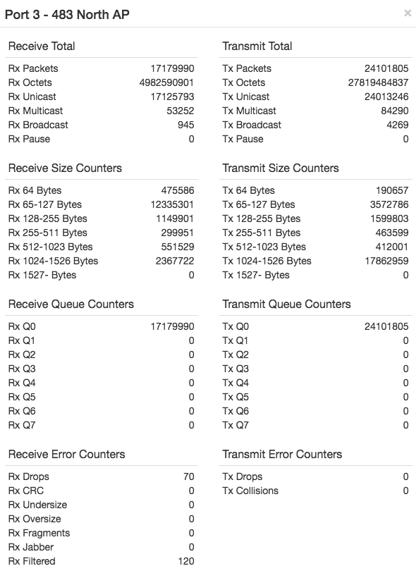

edit: regarding pause frames, not seeing any on that port, attached screenshot
port 3 stats
