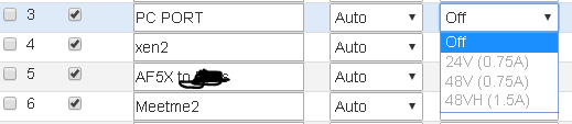

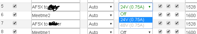

I've wanting to bump power from 24V up to 48V for an AF5X (date code says ok for 48V) but the PoE option in the WS-12-250A is greyed out...
A number of other ports also have all entries greyed out
Ideas?
power options greyed out???

Well first I moved your post from the Pictures section to the Hardware and Software problems section.
If a port already has an Ethernet link it will not allow you to turn POE on for that port or change the existing POE option.
I can not see your full screen so I am guessing there is already a link on the port you're trying to turn POE ON such as a link to a laptop.
The logic here is a safety sanity check in that if a port already has an Ethernet link without POE applied or an existing POE option why would you want to turn POE on or change the POE option and possibly damage the device and or the switch?
You will have to turn POE OFF then select the other POE option.

understood. I'll power the ports off before bringing them up at 48V. and yes, all those ports are active.
