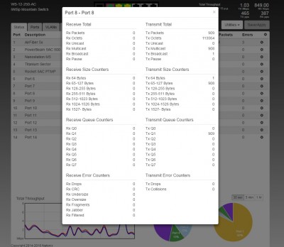

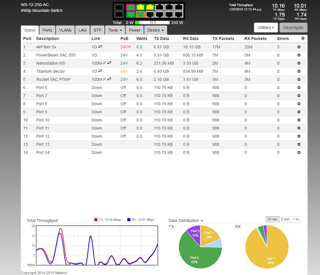

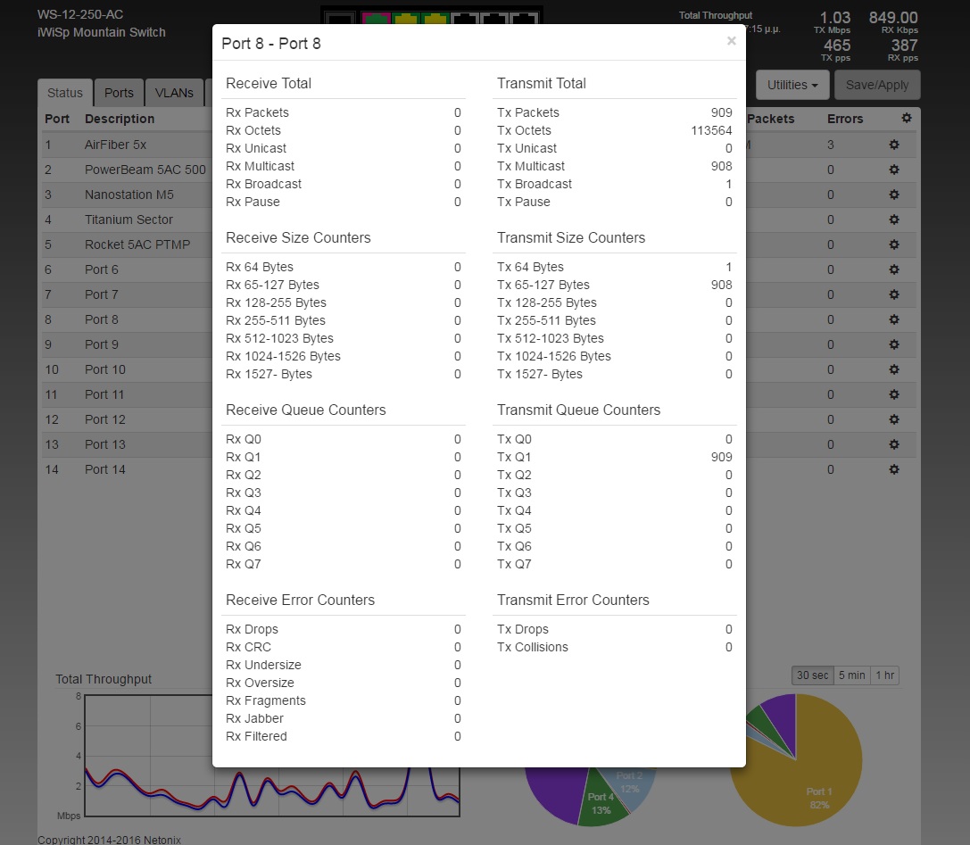

We have upgraded our WS-12-250-AC to v1.4.0rc19 F/W.
I ve notice (the first day of stats collection)
Pros:
1) Less memory usage
Cons
1)There is some not before recorded traffic on Powered off ports that it is about 1packet every 5-10sec. (attached screens)
This maybe it is normal but since i ve noticed after this update i think that it must be noted.

Mikea wrote:There is some not before recorded traffic on Powered off ports that it is about 1packet every 5-10sec. (attached screens)
It is our new Discovery routine looking for devices, it'll be fixed in the next release.
