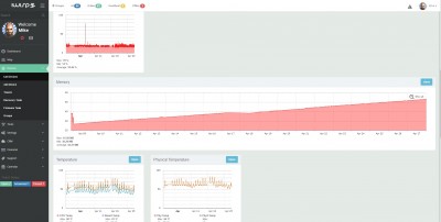

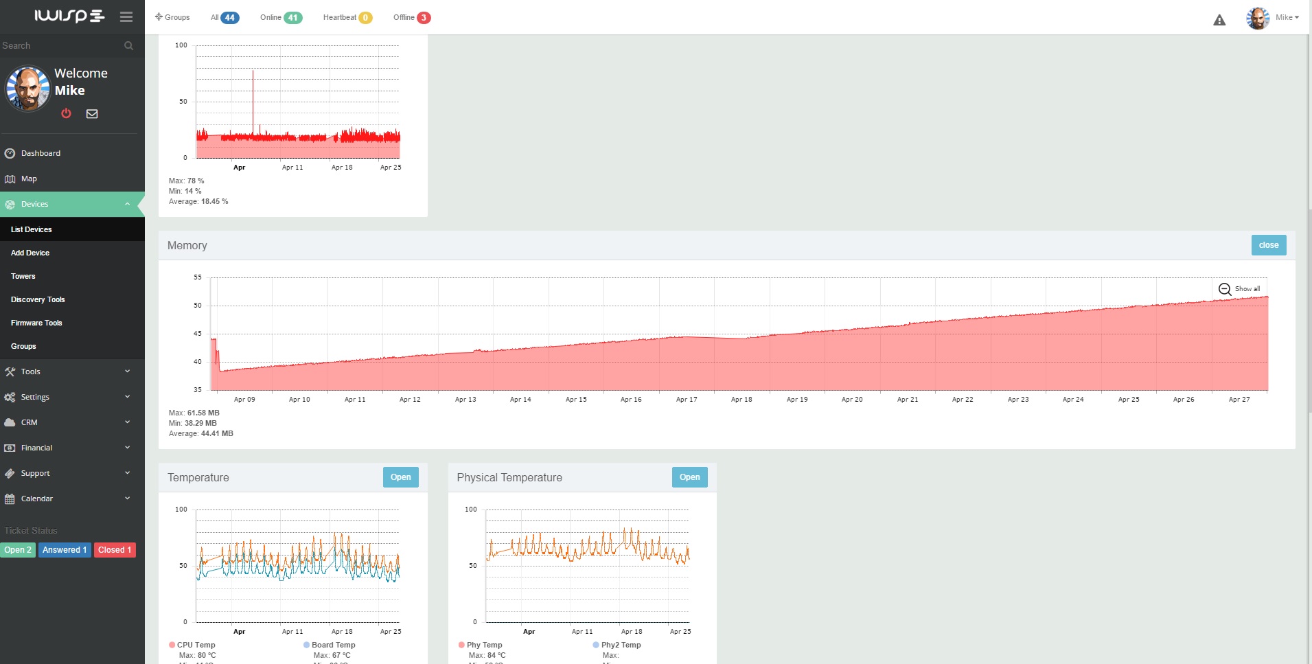

Hey all can you confirm the following memory issue.
Device: WS-12-250-AC
F/W: v1.4.0rc12
I ve upgraded to rc12 at April 8 and i m seeing the following mem charts.
Thank you for your time and efforts.
Plausible memory leak v1.4.0rc12 at WS-12-250-AC

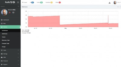

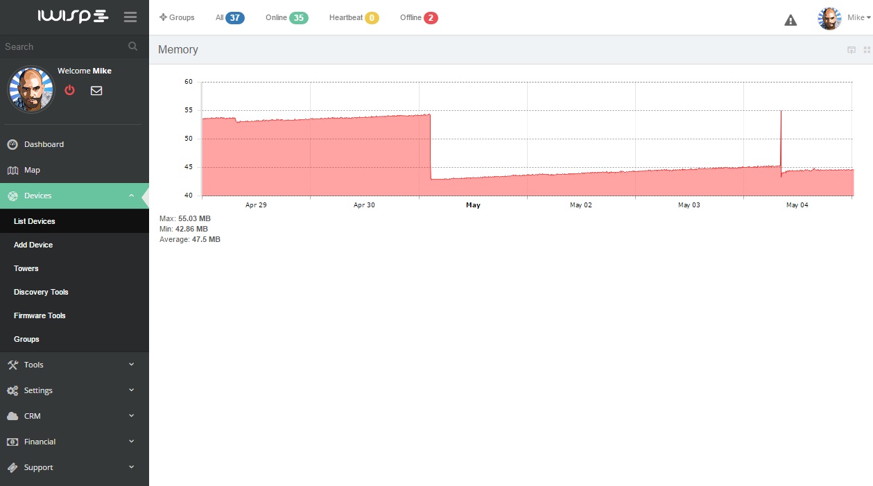

I can confirm that the latest F/W 1.4.0rc16 fixed the issue.
In the picture attached the memory usage isn't growing after the update.
Thank you Chris & Eric for fast update!
