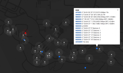

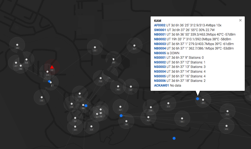

I have SNMP enabled, but since I consider all SNMP monitoring platforms to be bloated, inefficient, or too aggressive on hardware and network resources, I built my own, which does a single ping per minute, and alerts if the average latency over X minutes goes over Y much. It also connects via SSH/HTTPS and grabs JSON-format info about status, once every 10 minutes. See screenshot of my "dashboard"... (all PHP/HTML/JS based, road names removed for privacy)

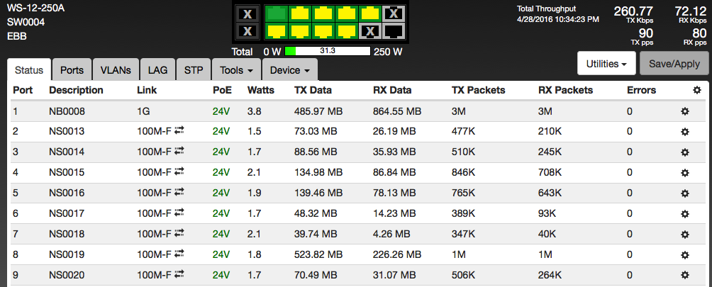

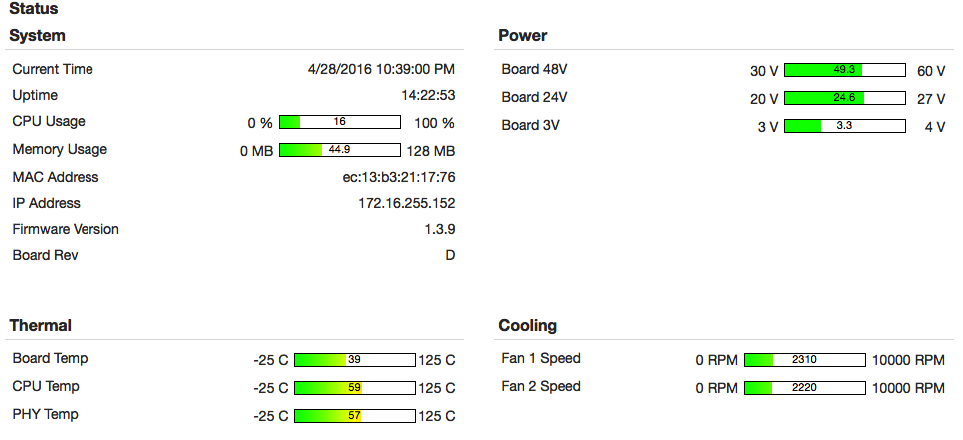

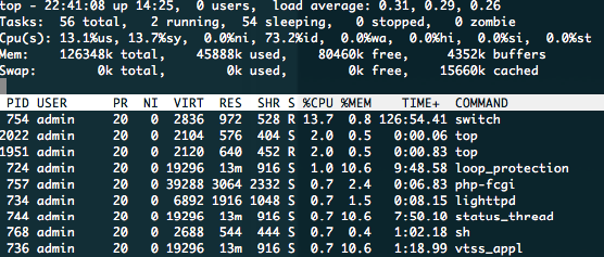

So, I'm having this issue on a WS-12-250A right now. I have taken screenshots of all relevant tabs, and even the top command run over SSH. As you can see, there is almost NO traffic through the switch.
In addition, ping times to the NanoBeam feeding into the switch are the normal 2.5ms average, pings to anything that is across the switch, on the other side so to speak, are just as bad.
I've read some comments from people having nasty issues with the suggested rc firmware, is it safe to use in a production environment?
