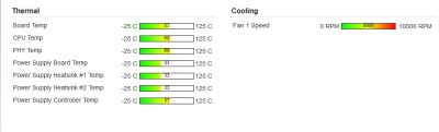

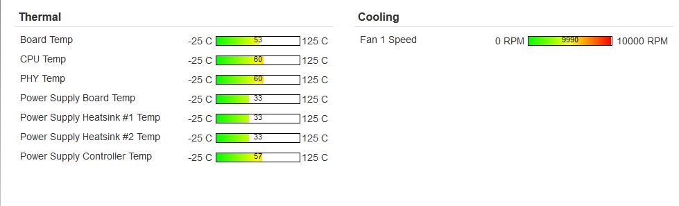

The switch is at v1.3.8, Board Rev. D, Power Supply Firmware v28...Today's 99F ambient temp shows RPM consistent between 9450 - 9990:
WS-12-250-DC Temperature and Fan Speed

The fan is controlled mostly by the switch board temp, Kicks on at 40C, at full by 50C, kicks off at 35C
After you upgrade to v1.4.0rc12 please post up the FULL device Status Tab again.

"The SMART DC switch will shut itself down if it gets too hot. First it will shed POE ports in an attempt to cool down but ultimately it will shut down if too hot."
How hot is "too hot" and which temp sensor(s) would determine that? What temp should we be watching?
In what order will the POE ports shed (the same as "Power" Priority)? Will the POE ports shut down come back up after sufficient cooling?

- I tested this design at an ambient of 55 degrees Celsius with a 200 plus watt POE load and vin=24 volts...runs no problem & well within design specs.
- if it does get to hot (uses power supply heat sink & power controller temperatures) it will shed ports.
- it will then turn ports back on after cools to within acceptable operating temperature for ten seconds.

"- I tested this design at an ambient of 55 degrees Celsius with a 200 plus watt POE load and vin=24 volts...runs no problem & well within design specs."
Was that with the fan operating properly (and at what RPM)?
Still would like to know...
How hot is "too hot" and which temp sensor(s) would determine that? What would the "too hot" readings be?
Re: WS-12-250-DC Temperature and Fan Speed
PHY and CPU are rated up to 125C
Most other parts on switch board are rated to 75C or higher
Board temps of 65C is OK
I think the power supply controller is rated above 85C?
If you're asking for a precise temperature things will fail then we can not provide that as most electronic components come with a range not a precise definitive temperature the component will fail.
They do not say "exactly and precisely at this specific temperature this will fail"
Dave - Employee
- Posts: 730
- Been thanked: 158 times
- we will start shutting down ports when power controller gets above 110 degrees Celsius for 20 seconds, or 105 deg for over 30 seconds.
- bgoode
- Posts: 21
- Joined: Tue Jul 21, 2015 12:20 pm
- Location: AZ USA
Thanks Dave...that's the info I was looking for.
