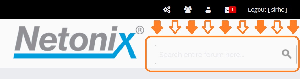

There is this new invention called a "search box"
A quick use of the handy search box looking for "Loop Protection" yields this post:
