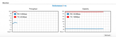

The switch all of a sudden stops passing traffic to the af5x. When you look at the traffic graph you see this :
Switchmain

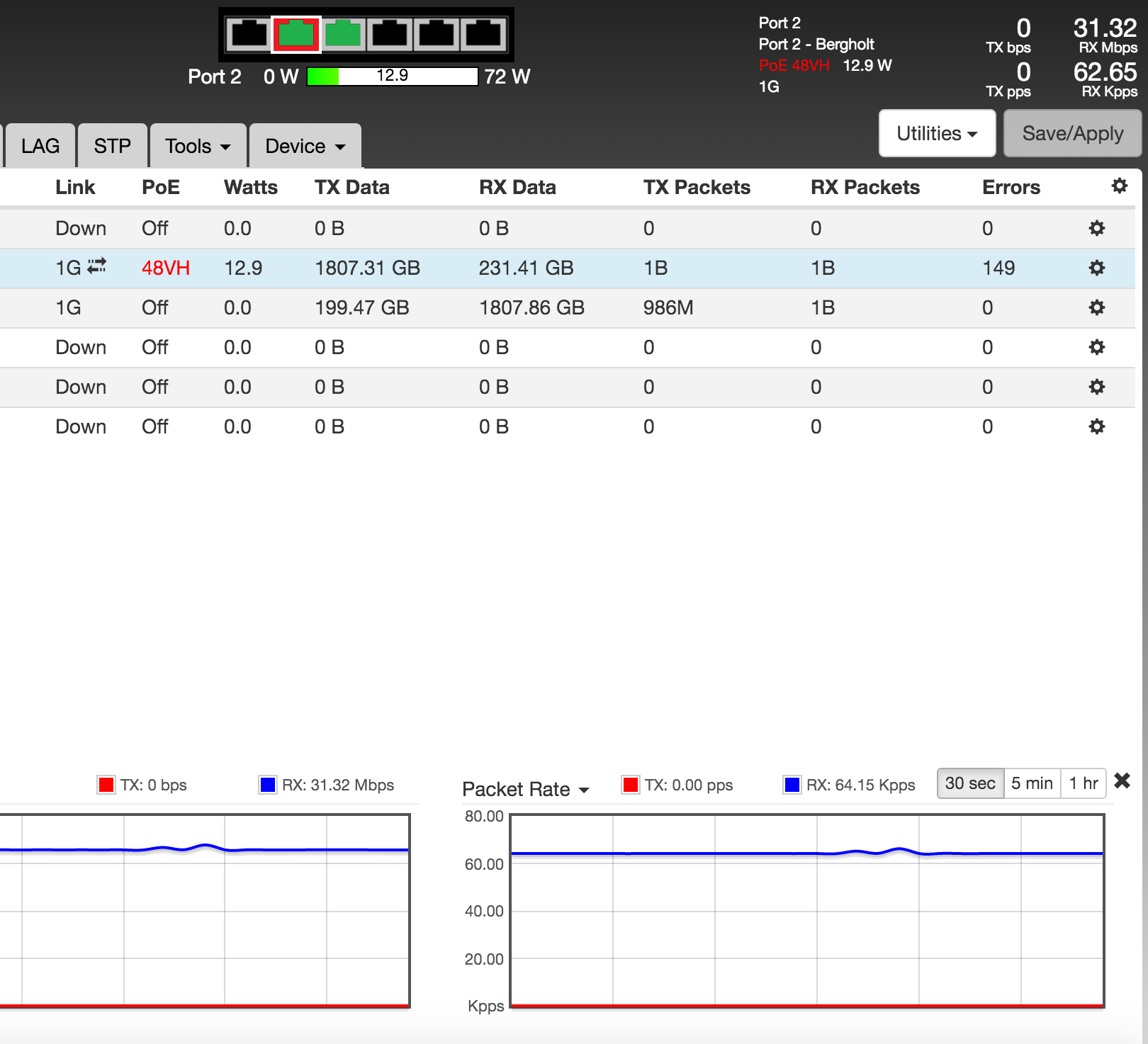

A huge amount of flat line packets and a constant speed of 30Mbits. BUT the AF tells a different story.. :
AF5x
This link goes 100% down until i reboot the switch. Port boucing the AF will only fix the issue for an hour. If you reboot the switch its fine for 3 days.

Well you either have a bad cable
Bad AFX <== My guess
Bad switch
Your going to have to figure out which one it is.
My "guess" is a BAD AFX
I have had several bad AFX radios that we had to replace.
