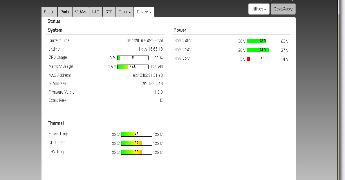

3V is out of range (3.5V) - WS-6-MINI
Just wondering if this is normal. My switch keeps dropping below 3.5v. I have a 6 mini being powered with an airfiber 24 poe injector. The switch is powering up a ubiquiti er-x router and a ubiquiti powerbeam ac iso, both of which are 24v. Total output watts is about 11. Any advice would be appreciated.

Firmware version is 1.3.9

Re: 3V is out of range (3.5V) - WS-6-MINI
Hi, seems maybe your A/D sensor circuit might be having a minor issue. More than likely the actually 3.3 volt supply is fine. You can can continue to use
it I think, or RMA it if you want to.
