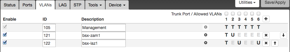

How can I send you the screenshot ?
I have 3 vlans:
ID Enable Description 1 2 3 4 5 6
105 true Management T T T T T T
111 true bsx-waw2 U U U U U U
104 true 6gnet-office T T T T T T
Port 1 is an ubnt bridge, port 2 is an IPTV box.
Connecting IPTV box directly to the ubnt bridge works perfectly.
Connecting with the switch there are 2 situations:
1. IGMP-snooping disabled: multicast works but goes to all ports (normal)
2. IGMP-snooping enabled: multicast does not work for a long while, sometimes after few minutes start working, BUT it's acting like igmp-snooping is not enabled: multicast goes to all ports. Sniffing packets on both ports, I can see igmp packets from IPTV box going towards the switch but never reaching the UBNT bridge and vice versa.

Here's the screenshot. As I wrote before with IGMP snooping disabled, multicast works but goes to all ports. Enabling IGMP snooping stops multicast from working for first few minutes, after few minutes (not always) it behaves as if IGMP snooping was disabled and traffic goes to all ports....
We're building an ethernet network in a 30 apartment building with 12 port switches and really need to get it to work to support IPTV...

by multicast flooding to all ports I simply confirm that multicast works as expected with IGMP snooping is turned off
The setup is quite simple:
Multicast Server -> Juniper router -> Netonix switch -> IPTV box or laptop
Port 1 connected to a Juniper router , 802.1q tagged vlans:
105 - managment only
121 - internet (data)
122 - IPTV
IPTV settop box or laptop with VLC box connected to port 3 (untagged for vlan 122)
Tried also:
multicast source (Linux, iperf) -> vlan122 (tagged) -> Port 1 of Netonix then Laptop to port 3 (untagged vlan 122, iperf). Even in this setup I did not see any IGMP queries coming from Netonix switch and with IGMP snooping enabled, there was no multicast passing through the switch for quite few minutes, once multicast started getting through, it would go to all ports connected on the switch (even though IGMP snooping would mean it should not..)
