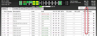

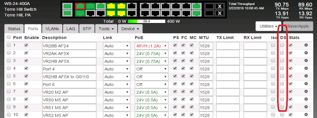

I can tell you that checking or unchecking Multicast on a port does not block DHCP discovery, however make sure you do not have the check mark on the DS column which is DHCP snooping and will block DHCP Discovery from that port to any other port.

The DS is not and has not ever been used.

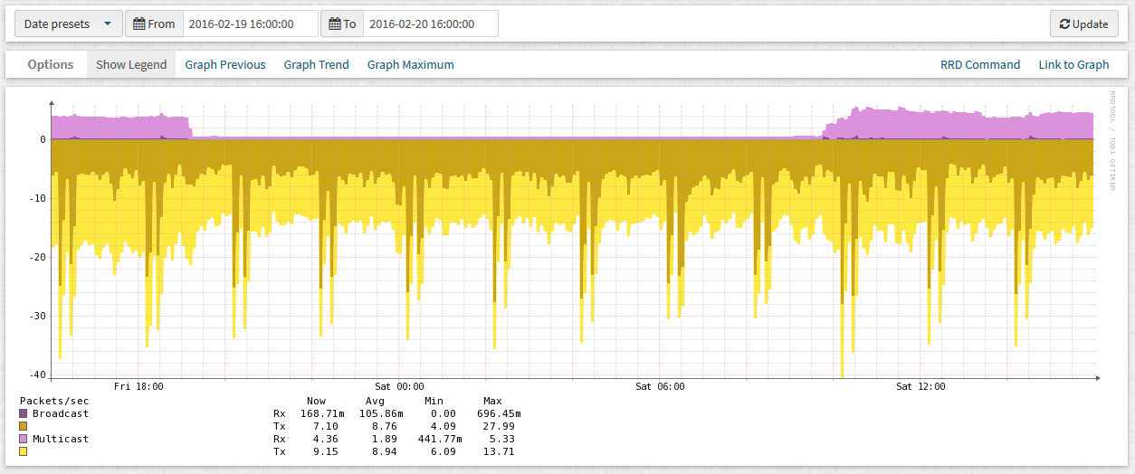

The graph is what happened after we removed the MC check mark on all ports. We did NOT notice the affect at the time. However when the leases ran out on the end users devices, and those devices did a DHCPREQUEST to reaffirm the current IP that traffic was blocked, however a device will keep its last known IP. If a end user did a reboot of their router then there would be NO IP and a DHCPDISCOVER would be blocked also. The net effect was no IP so no service.
The bottom line is we tailed the log and looked for traffic during those times from that location there were none, zero, nada. DHCPDISCOVER and DHCPREQUEST were unable to get to the DHCP server. At the end issue we did a wireshark capture to t-shoot the issue, we monitored the port that the WS connects to and did not see any DHCPDISCOVER and DHCPREQUEST come through. All we did to restore service was to place a check back in the MC and apply, then all the users grabbed a lease within a hour.
