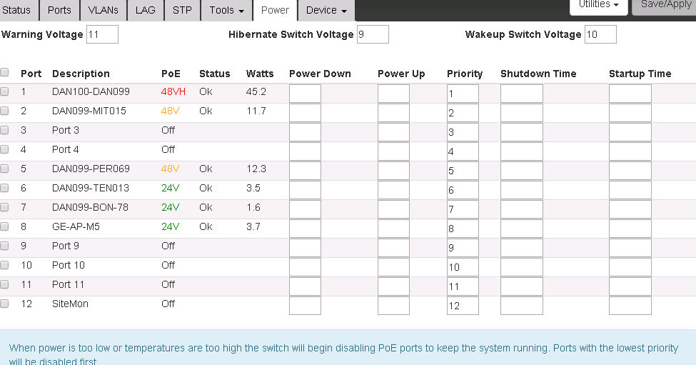

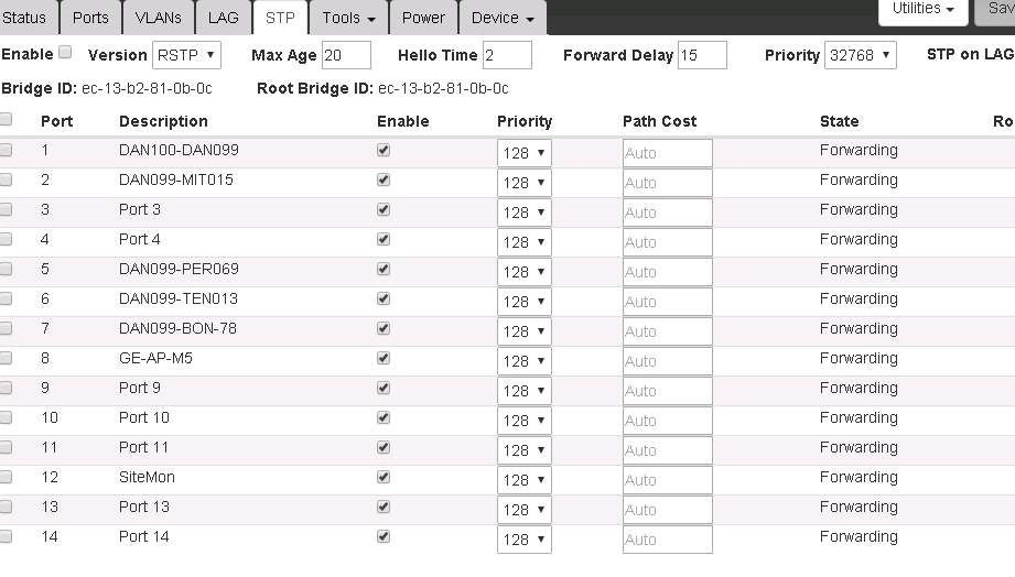

Please add the Power and STP Tab to your post.

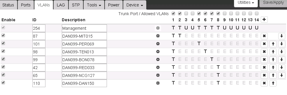

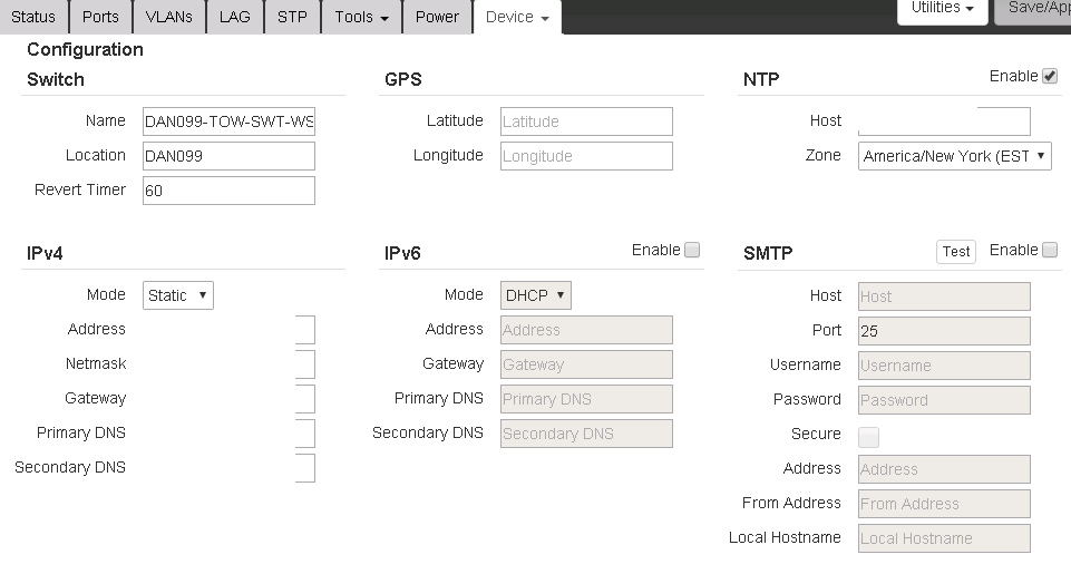

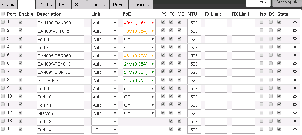

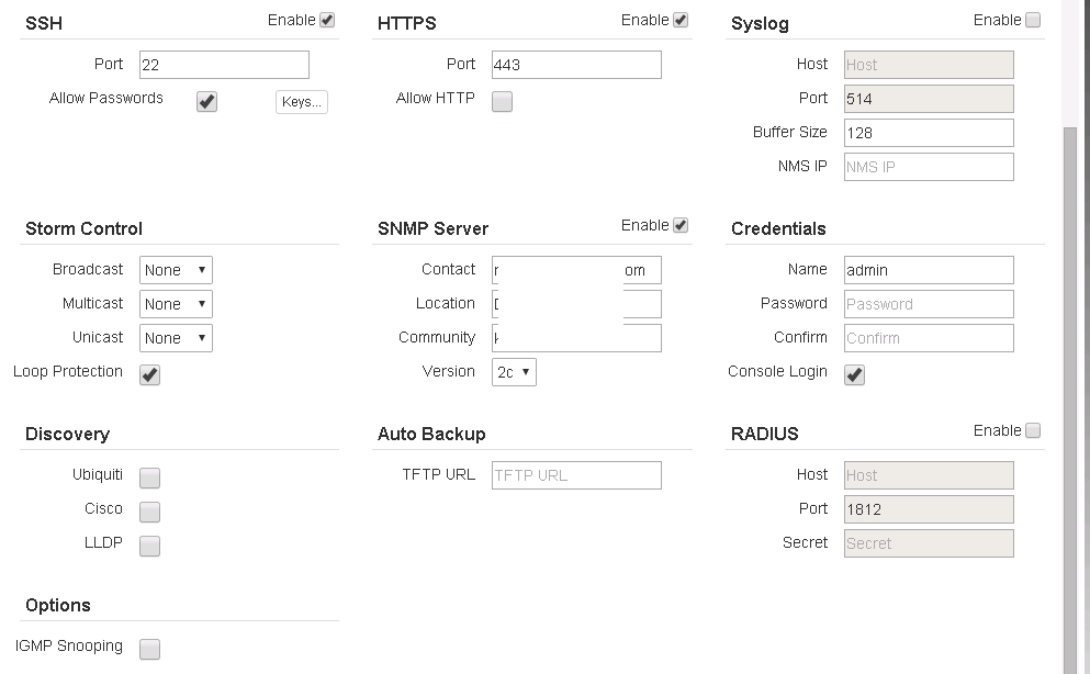

Your config looks fine.

Maybe try using RSTP instead of Loop Protection if it happens again as Loop Protection can be triggered by a any type of loop or leaky VLANs even at a customer location.

Ok - syslog configured. If it happens again, we'll try to get someone up there with a serial console.
