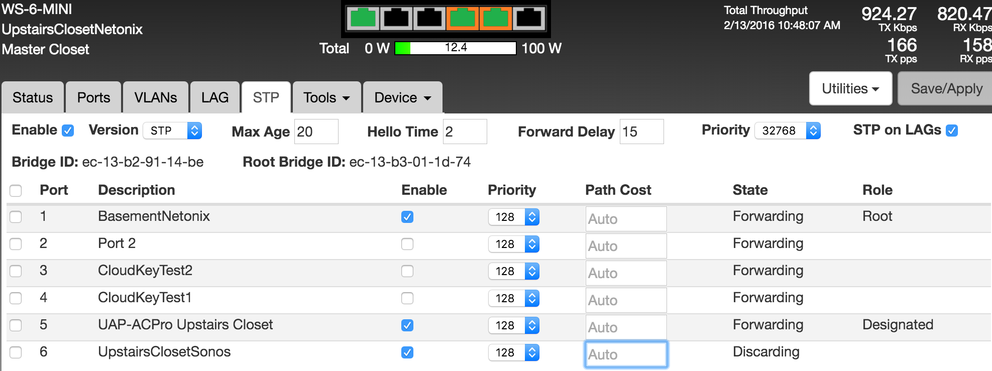

However, the guidance on configuring this from Sonos is fairly limited and references a Cisco switch. My attempts to replicate the recommended configuration settings on the Netonix switches have not been met with success. For example, when trying to enter the recommended value of 10 in the path cost section for the ports connected to wired Sonos players of the Netonix web interface, the interface doesn't let me and won't accept a value less than 16 (even though the hovering tooltip indicates a value all the way down to 1 is acceptable). I also don't see anything related to some of the other settings like BPDU handling and Path Cost default values. I've attached a screenshot of the STP settings on one of the Minis. All switches are running the latest stable firmware and the basement switch is configured as the root.

Thanks, but as the screenshot indicates, I have done that. As far as the status indicating Discarded, I believe it does that because the port is unplugged. As soon as I plug it in, it takes the network down with a broadcast storm, even when STP is active.

STP will choose the shortest path if the 2 are same cost. If you have multiple switch between Sonos, STP could choose the mesh with less device between. Can you configure your Sonos STP ? If yes, thoses choose higher value on mesh STP. Else, you can go lower on switch port (16 instead of 256).
Also, 16 is the same value as 1. Since 16 X 16 = 256, some must be configure from 16 to 256 by step of 16 while other brand choose from 1-16 instead.
16 = 1
32 = 2
48 = 3
256 = 16
